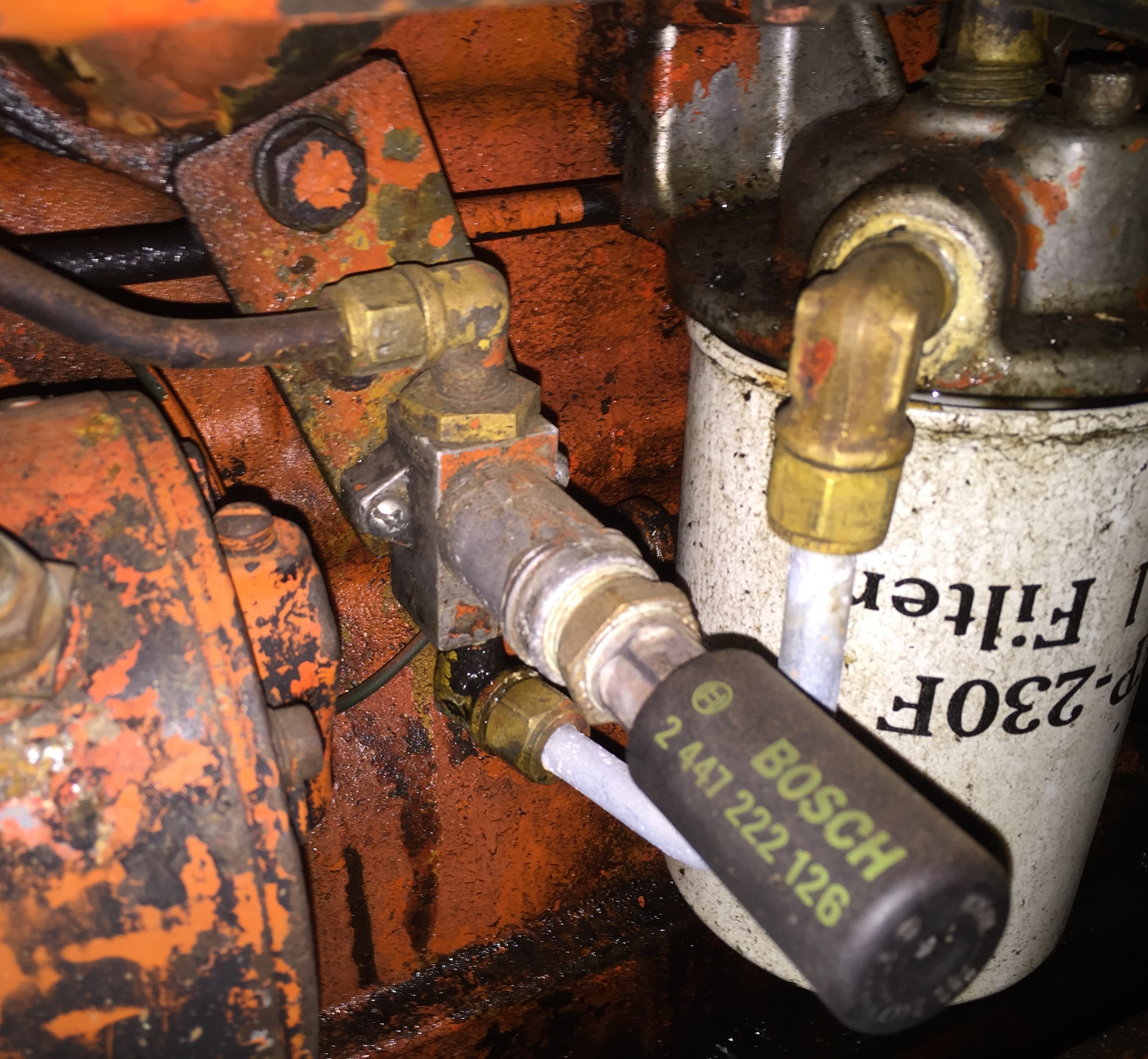

i have a 220 and a 190xt and both have primer pumps that leak as much fuel as they pump when using them. so today i made some changes to mine and got rod of the rubber plunger and replaced it with a sealed bosch pump as used on other tractors. cost about $30 to do the change and about 30 minutes,

darrel, i got the pump from my local pump rebuilder. i have bought the kit from agco but i have always got squirted with fuel when using the pump. with this bosch change i dont get squirted and it seals good.

A quick search for the part number in the picture took me here (I ordered a couple one for my XT and for my 7000 (they both like to squirt too!)

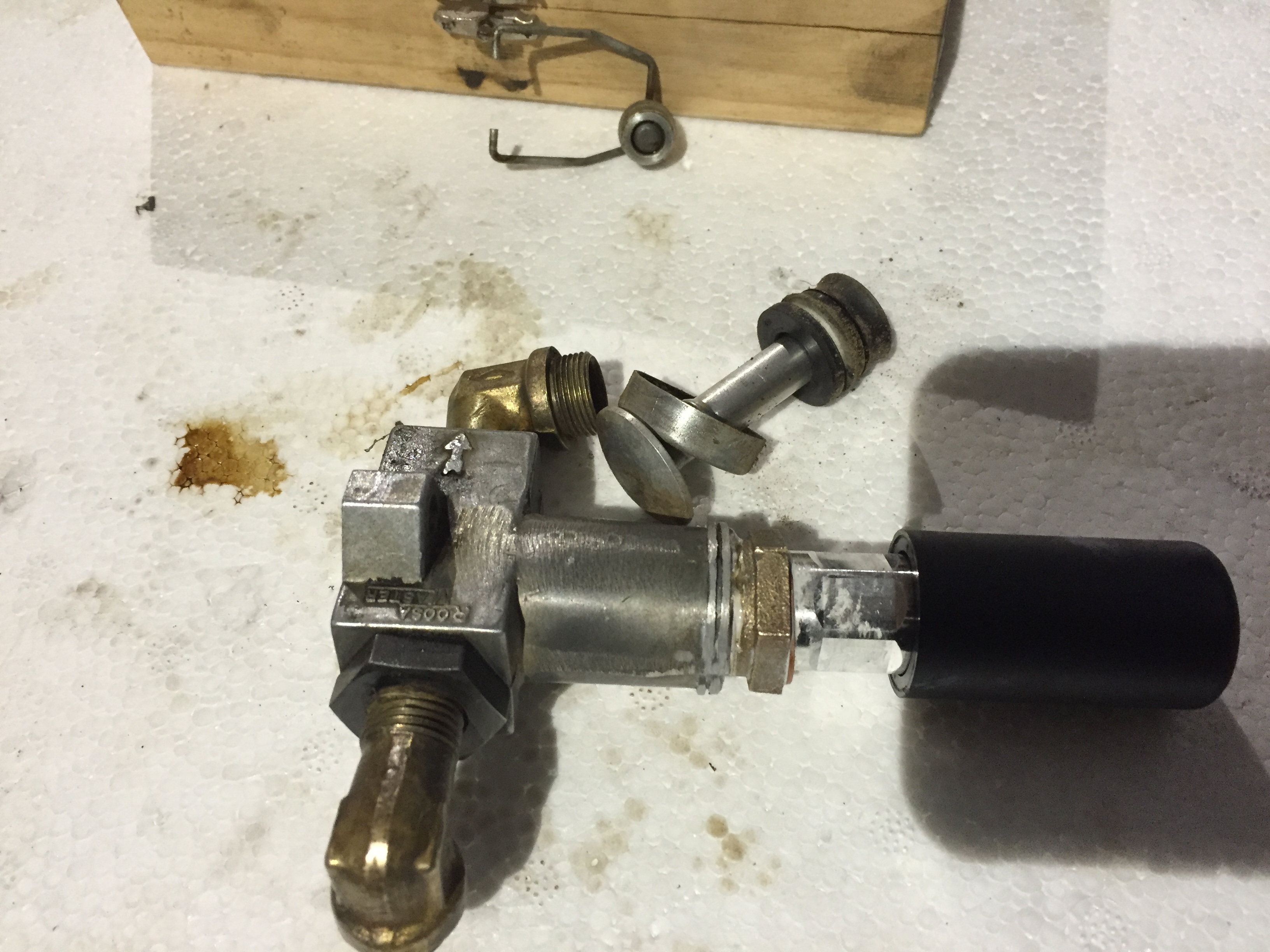

here is a link showing the steps i took to me this work.
http://www.grandpastractor.com/kunena/allis-chalmers/1493-190-diesel-hand-primer-pump-rebuild.html

that looks like a pretty good setup, but I sell the complete rebuild kits for the primer assembly for around $70. The plunger is 45 of that. What you don't see are the 2 check valves inside that get clogged up with crap and create a major restriction of fuel flow to the pump. Those check valves are about 10 each. Putting on the Bosch primer does nothing about the 2 check valves inside. New replacement plungers don't leak either. Once that bosch primer is 40 years old, it will be leaking too lol!

http://www.grandpastractor.com/kunena/allis-chalmers/1493-190-diesel-hand-primer-pump-rebuild.html[/QUOTE]  So you just adapted the Bosch to the OEM barrel?  Think that would work using an elbow so it is upright? That is plunger only? Still using the OEM valves in stock body? Thanks....Dale

Yes Dale,  I only adapted the new pump to the barrel and left all the original check valves and spring intact.  I don't see why you couldn't put in an elbow it should work fine with one I would think if there is room to still pump the pump.
