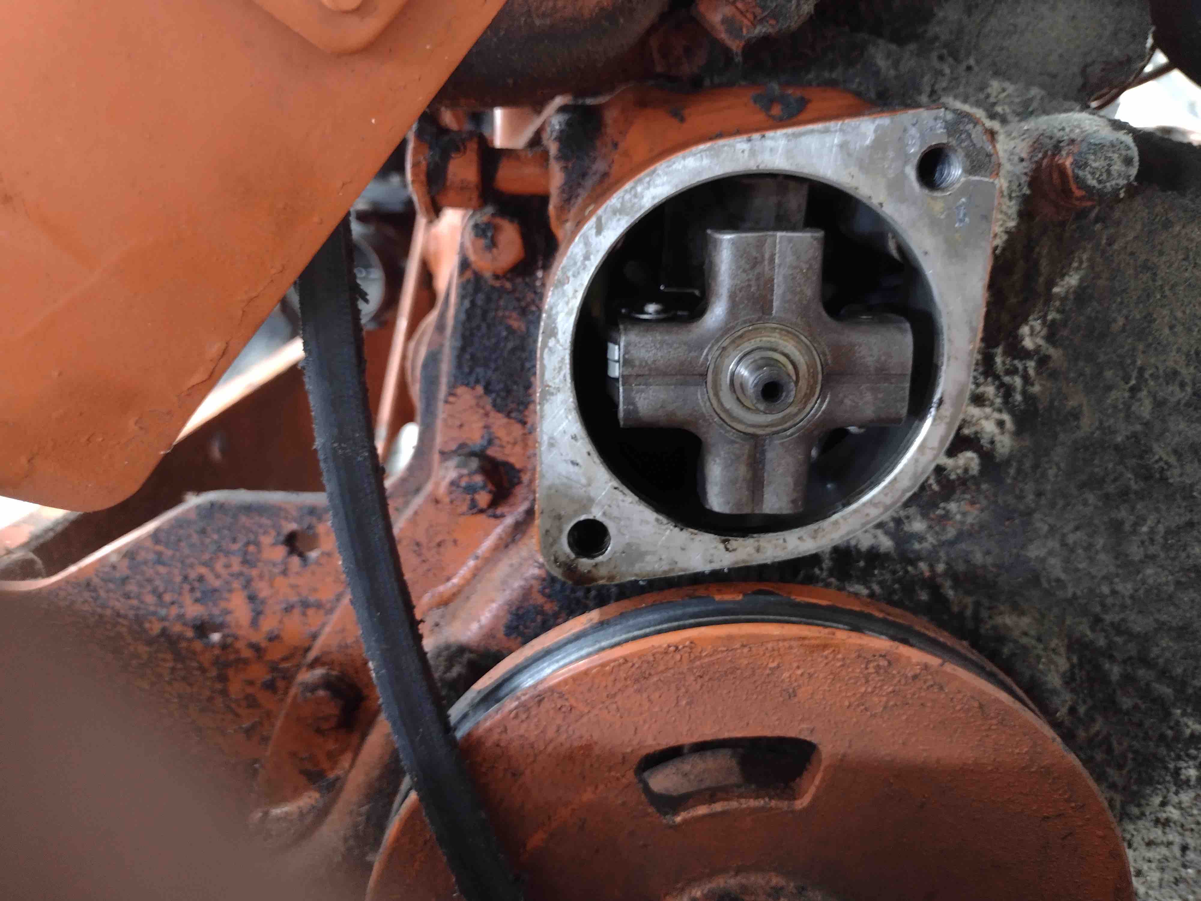

Driving the tractor a little more there is a lag in response when I open the throttle and it seems like the governor is not very responsive when the tractor encounters a hill or additional load.  Pulled the sheet metal and radiator.  Got the cover off the governor and here's what I see.  How do I proceed?

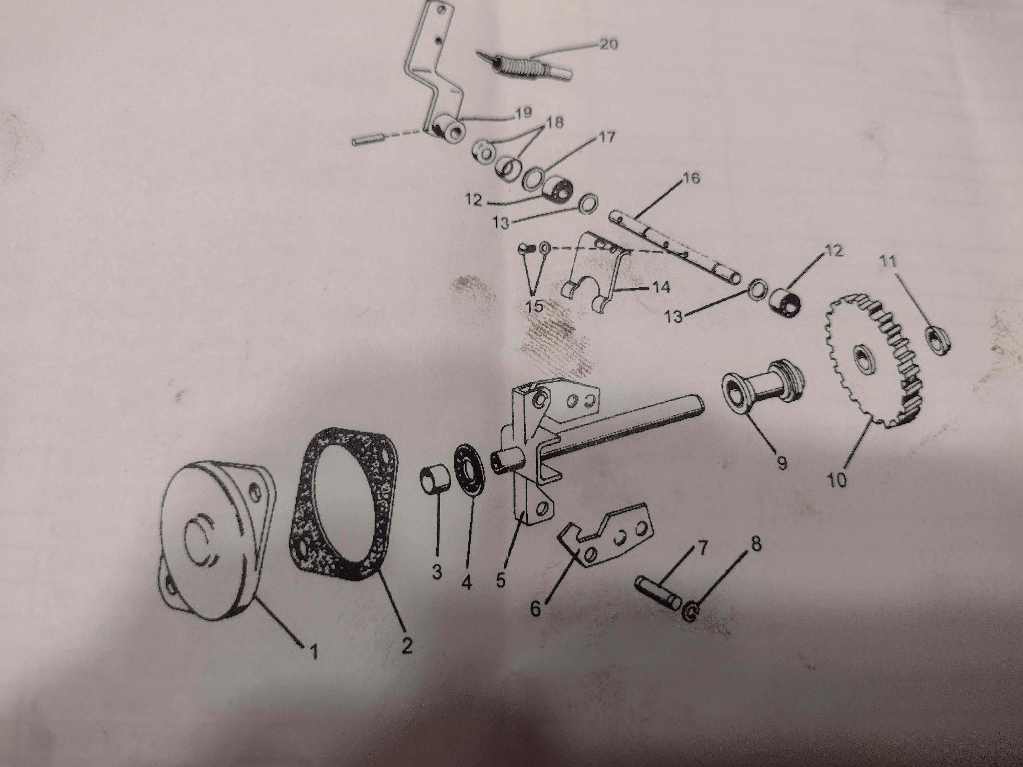

Here's the parts diagram I got from the local dealer:
What should I be checking that might be giving me the problems I have with throttle and governor response?

Generally, not tearing it all apart until you have properly adjusted the linkage  to the carburetor!!     I thought you were concerned about an oil leak and looseness in the shaft ??   The governor weight assembly will pull right out of that hole if you disconnect the link rod to the carb and let the governor arm fall way down to horizontal.

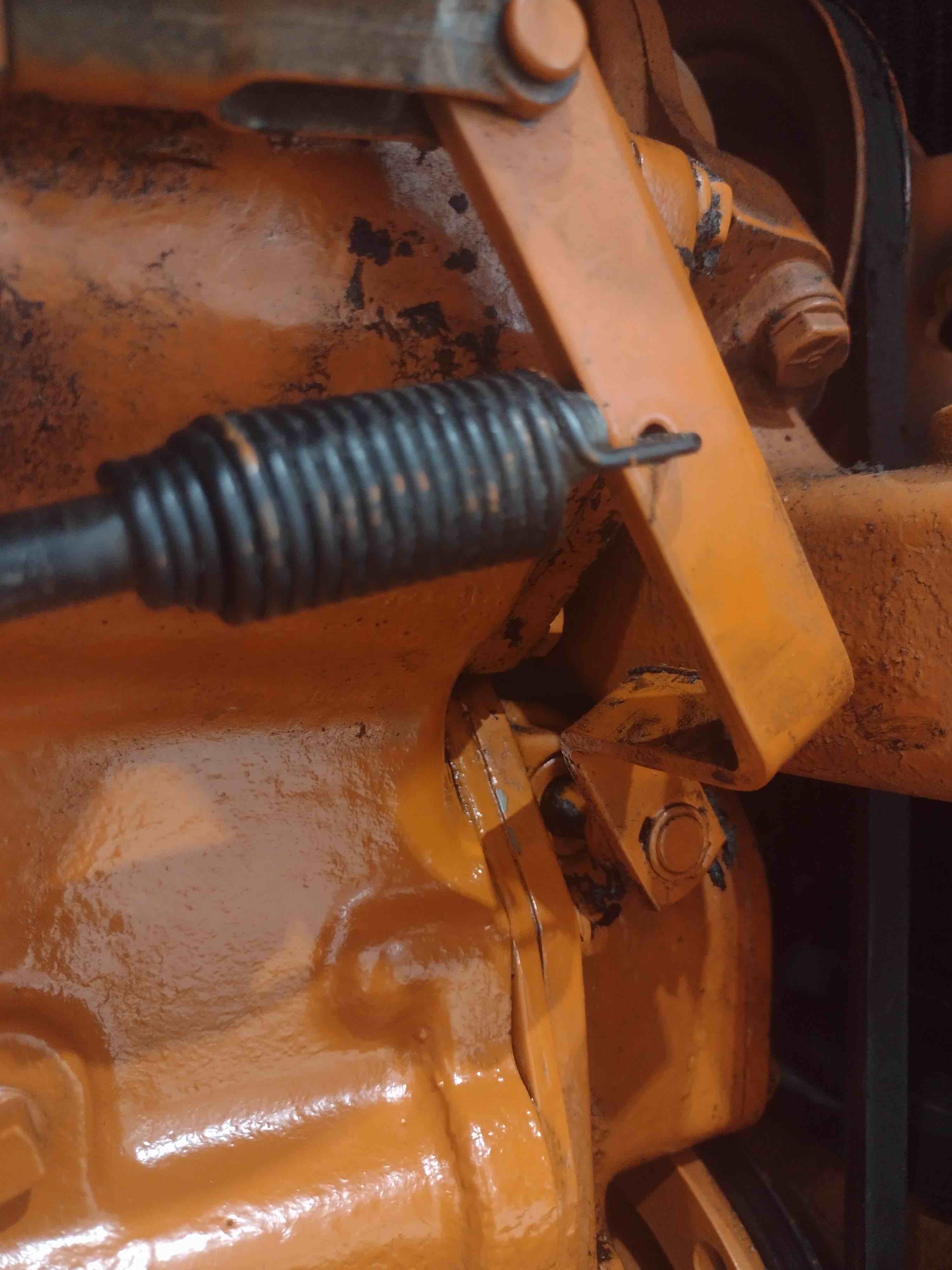

There was a bend in the rod from the carb to the governor arm that was causing a little interference, fixed that and the problem of response didn't change.

Proper adjustment of the governor to "synch" it to the carburetor. Hand throttle wide open with the engine OFF. Disconnect the link rod to the carb at the front. The length of the rod should be just so you can slide the pin back into the yoke when the rod is pushed to the rear as far as it will go. From that point I would turn the yoke 1 more full turn shorter and maybe even 2 full turns shorter. A drop of oil on each end of the link rod. No binding anywhere. Even oil the spring to help it slide. That is proper adjustment. Now, I will tell you a stock OEM governor on those engines wasn't very impressive until you got up to 2,000 RPM or more. They just weren't. I have worked a couple of them over to help with mid-range sensitivity but it takes governor weights from a Gleaner model G combine to do that.
