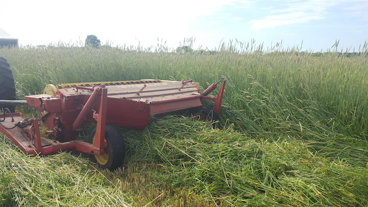

Guess it depends on what you want to accomplish. I'm relying on.....and am OK.....with old, obsolete equipment* as I'm a small acreage hobby guy. But still no reason one shouldn't shoot for "hay up to the armpits"!
This a 7' NH haybine.......cutting rye, but hay is the same. My 1st cutting last year made 130 50# bales to the acre......over 3 ton......1st cutting.
Thick enough that only a couple 7' windrows put together will force me to bale in 1st or 2nd gear with a NH 315 baler......dropping a bale every 25 feet or so.
