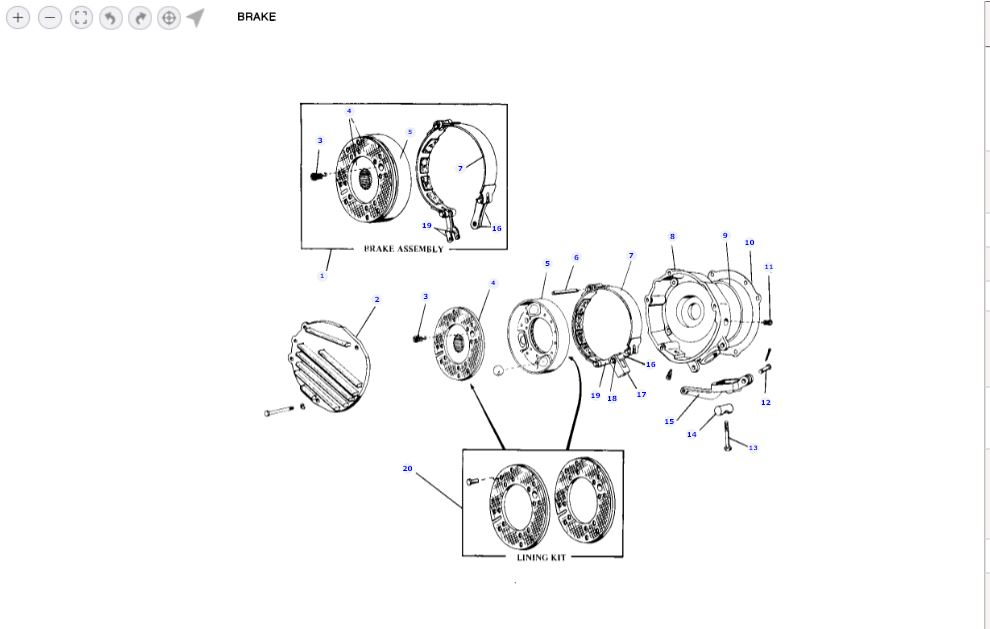

Brake housings are accessed from under the platform not through it.  Follow the pedal linkage and you will find this:
Charlie175 View Drop Down
Location: Shenandoah, VA
Points: 6369
Post Options Post Options   Thanks (0) Thanks(0)   Quote Charlie175 Quote  Post ReplyReply Direct Link To This Post Posted: 26 Oct 2020 at 5:15am
Front the front of the rear tires, look back at the axle. Follow the axle to the main housing, you will see the cover as shown in Item 2 above

So I was guessing right, through the round panel above the gear.  I'm not a small guy and have arty-ritis so my best bet is to remove the wheel for free/clear access to the brakes through that panel.  This tractor does not have spin-out rims/hubs so off it comes.  Easily.... I hope... LOL

Just looked under there.... will be tight I think but doable.  I don't see any need to remove the wheels, cover is not at end of axle like I thought.   I hope I can get to them end of the week, hopefully.  Fingers crossed, clean out and hit with brake clean.... all finders crossed..... LOL  First job on her this week will be removing one hyd and one fuel line, *possibly starter solenoid to put in block heater.  Well, first job next couple days... bow hunting in this 20 degree daytime weather...... brrrrr
