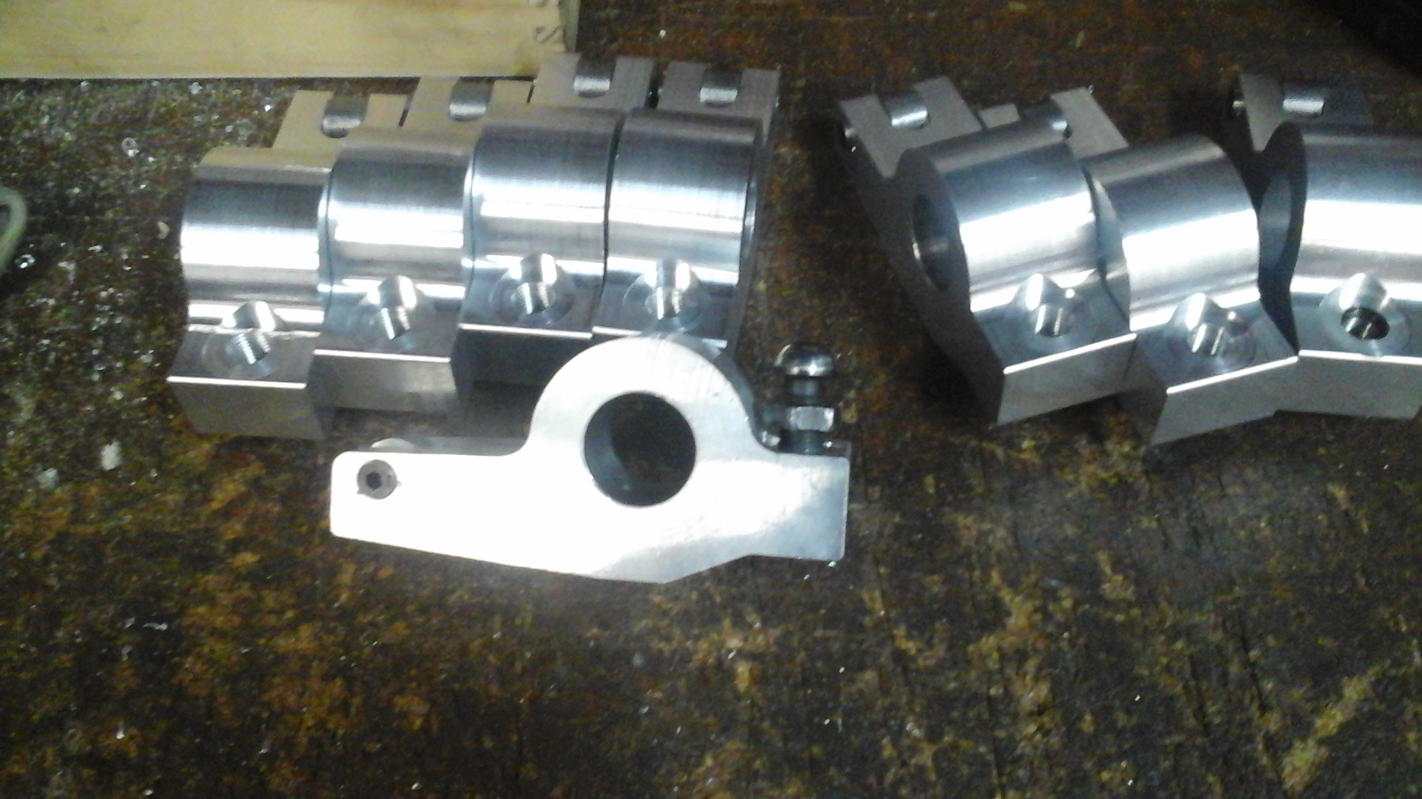

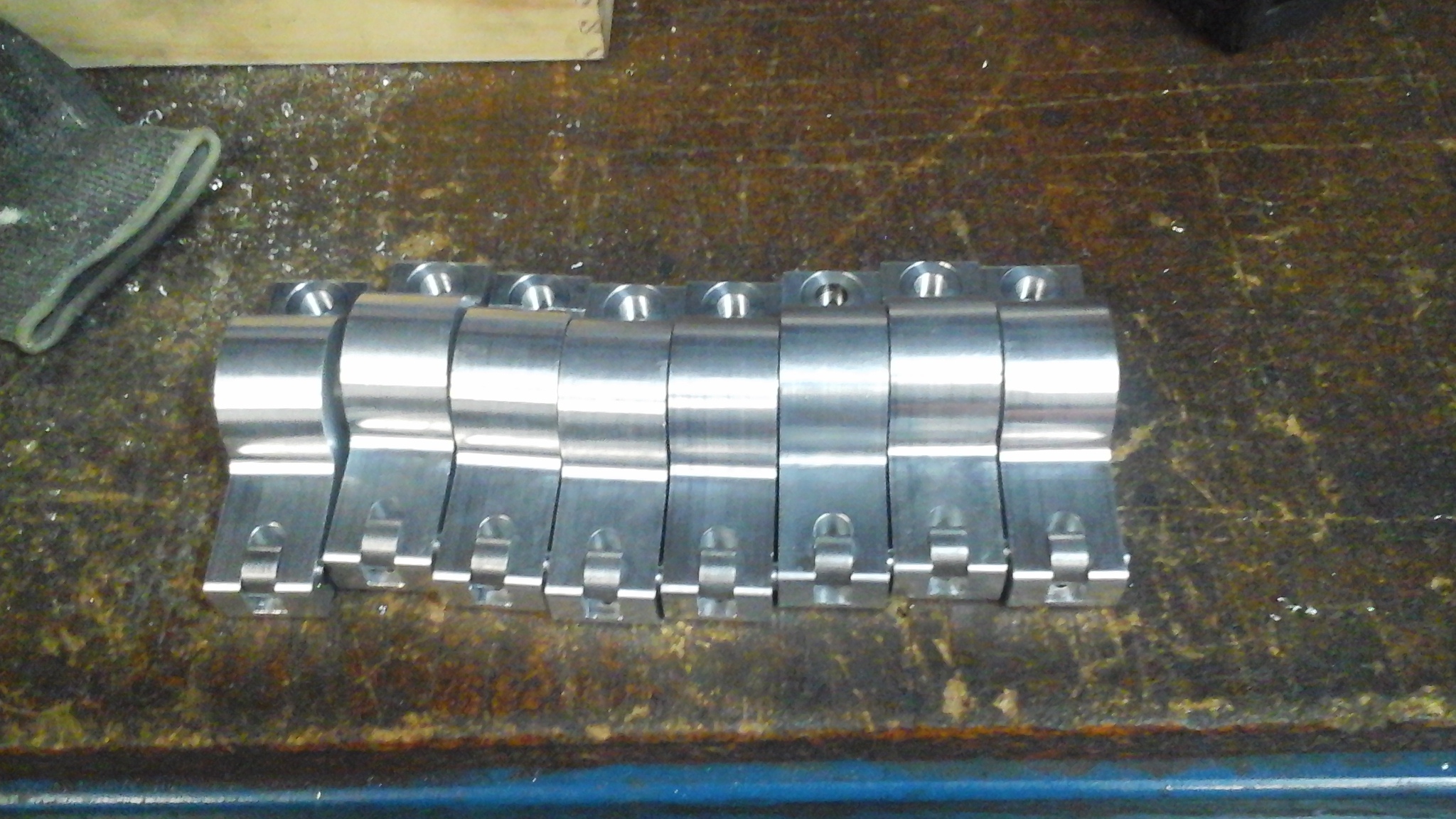

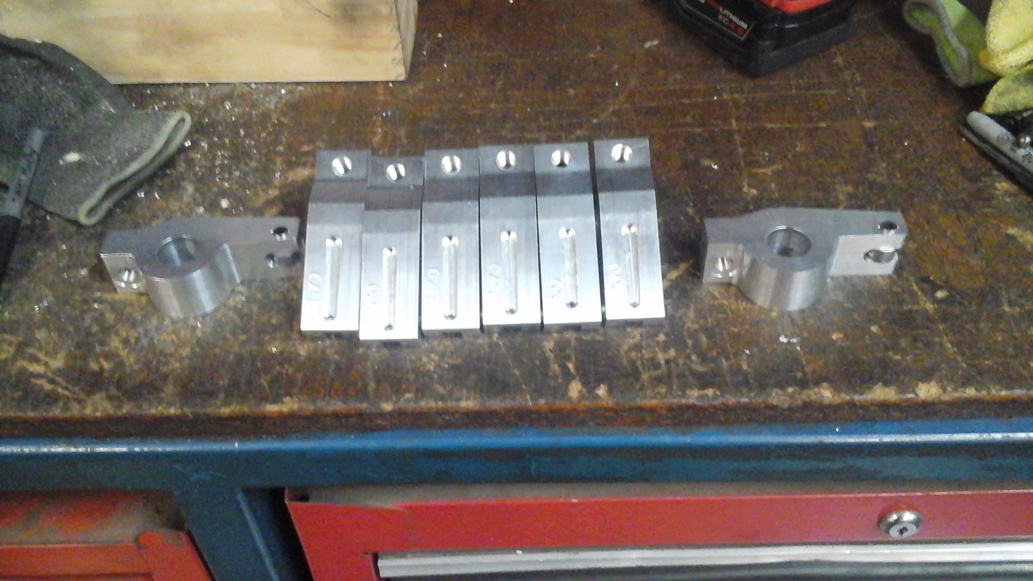

Post Options Post Options   Thanks (0) Thanks(0)   Quote Robacpuller Quote  Post ReplyReply Direct Link To This Post Posted: 14 Nov 2020 at 6:42pm
Here r pics of finished rockers.
