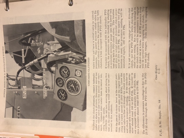

Does anybody have any troubleshooting tips, hydraulic schematic, or possible trouble shooting flow chart for this issue. I purchased the 185 knowing hi range didn't work, tractor just stops when you shift into high. Any help is appreciated.

I have the manual, it tells you to check the high and low in the same place under the steering column, and that just doesn't sound right to me, I would figure there is a way to test on the output side of the valve so I could se my pressures coming out of the valve, and isolate it being a valve problem vs a clutch pack problem.

Look, I’ve checked the pressure, there is one spot to check the pressure according to the ac manual, that one spot is supposed to check hi, low, and neutral, I don’t see how that can tell me if the pressure is actually leaving the hi side of the valve and making it to the clutch pack!! If you ain’t got nothing constructive to say stay off the post. It’s better to be perceived as moron then be proved one.

The manual says 255-270, and that I can tee into the line off the orbital motor or the bottom plug of the clutch valve. But your saying if I have low and not high it is most likely in the director? When I get into the director will I just be looking for worn out plate or an internal leak of some sort?

Draining a bit of oil out of the housing and looking for metal or clutch material can provide a clue. If debris has passed around in the system you could have both mechanical and hydraulic problems.
The tester they are using tests flow and pressure, a simple gauge reads only pressure.
 Using a flow meter style tester as shown - If you have flow and no pressure in High it  means there is a leak somewhere that needs to be found, probably inside. I think there are some steel tubes inside a cover that could be inspected. If you have correct pressure and correct flow there will likely be some sort of clutch disk or spline problem.
If you have pressure and low flow or no flow there may be some sort of blockage in the circuit to the hi clutch.
If testing with a pressure gauge you may have to cap the lines that feed into the clutch. Capping the lines to the High and Low clutch and getting a very similar pressure reading in H or L means there is a leak inside somewhere. With the lines capped and pressure in Low and none in High means a valve or linkage problem.
Points: 22755
Post Options Post Options   Thanks (0) Thanks(0)   Quote DrAllis Quote  Post ReplyReply Direct Link To This Post Posted: 20 Nov 2019 at 7:12am
Down underneath the right platform is the manifold that goes to the Power Director clutch. The brake latch mechanism is attached to it. Anyway, there are two allen head plugs on this manifold. No need for a flow rater or removing any sheet metal. They are 1/8" pipe thread. Connect a 500 psi gauge to each one to check pressures. They should be nearly exactly the same for LOW and HIGH and pretty near zero when in neutral.  You've either got a massive leak in high side or all the driving discs are broken inside.
