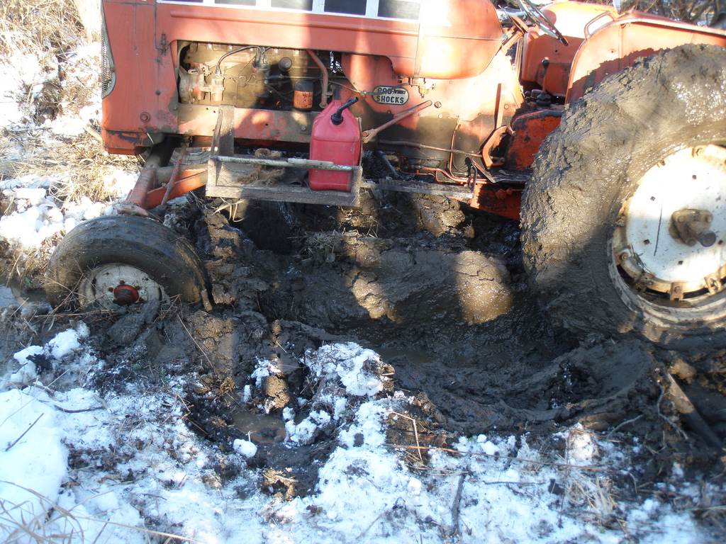

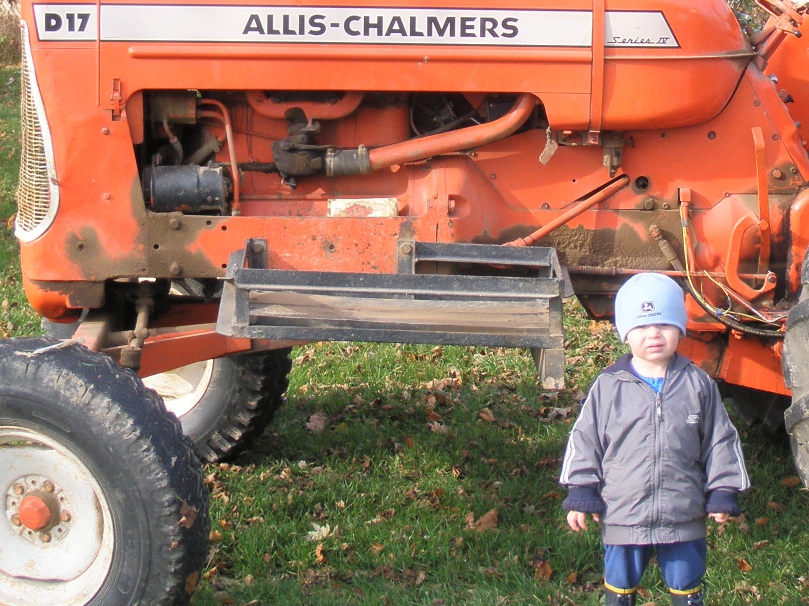

Oh, then must be we threaded the holes on our D17's. Come to think of it, the D19 stone box doesn't use the frame rail holes at all. It uses "hangers" that go around the hole top of the frame rails, almost like a hand clamped to the frame. See:
BUT, the D17 stone box here is def threaded into the frame, so is the snowplow we made for it. Believe me there there are no nuts on the other side of those bolts. Simply threaded right in to the frame; it's nice and convenient.
And our D14 which we also made a snow plow for; threaded:

Daniel, the little tyke there looks ready to defend HIS D17,  no one dare to come near!
Edited by JoeO(CMO) - 08 May 2010 at 7:36am

I knew it. Look at the front hole in the D14 where the snow plow is mounted, if it wasn't threaded there's NO WAY you could get a nut or let alone a wrench back there lol.
No way you could get on that one from the back!
