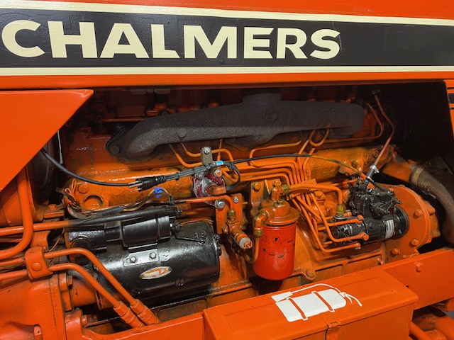

Last year I installed a coolant heater tank type on a 185 using the bottom radiator drain coming out of the heater going into an outlet up by the thermostat. It works great but this 185 does not have a place by the thermostat tapped for a nipple. Where do y’all go in-this situation? Thanks. Dana

I have drilled and tapped the thermostat housings many times over the years.
Lynn Marshall View Drop Down
Location: Dana, Iowa
Points: 2482
Post Options Post Options   Thanks (0) Thanks(0)   Quote Lynn Marshall Quote  Post ReplyReply Direct Link To This Post Posted: 17 Dec 2023 at 8:04pm
Couple of other things. I would have thought that 185 either had a factory type block heater on the right side or at least the holes would be there to put a factory heater in the block. If you are committed to the tank type heater design, then I used to run the lower heater hose back to the block drain rather than the radiator drain. I believe that the heater will work better and heat the block more efficiently.  If the way that you have the other 185 plumbed works, then just do the same.

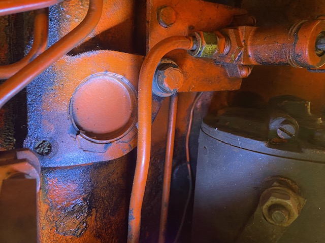

Post Options Post Options   Thanks (0) Thanks(0)   Quote captaindana Quote  Post ReplyReply Direct Link To This Post Posted: 18 Dec 2023 at 5:55am
Is this circle thing what I remove to put heater into? If so how does one remove, I never have…

Post Options Post Options   Thanks (0) Thanks(0)   Quote Alvin M Quote  Post ReplyReply Direct Link To This Post Posted: 18 Dec 2023 at 7:28am
Make sure the top hole has good threads first then use sharp tool punch hole in plug and pop plug out then clean paint off real good install heater with gasket

Post Options Post Options   Thanks (0) Thanks(0)   Quote Lynn Marshall Quote  Post ReplyReply Direct Link To This Post Posted: 18 Dec 2023 at 7:57am
Exactly what Alvin said. 7/16ths coarse thread tap.

Post Options Post Options   Thanks (0) Thanks(0)   Quote HudCo Quote  Post ReplyReply Direct Link To This Post Posted: 18 Dec 2023 at 8:26am
that is the frost plug if their is a kats block heater for it ,   parts store should be able to find aplication

Post Options Post Options   Thanks (0) Thanks(0)   Quote captaindana Quote  Post ReplyReply Direct Link To This Post Posted: 18 Dec 2023 at 10:03am
Ok y’all got me confused (doesn’t take much). Block heaters I have on other engines just slide in the block and get tightened so the rubber O rings seal. Apparently you guys have ones that bolt on??
