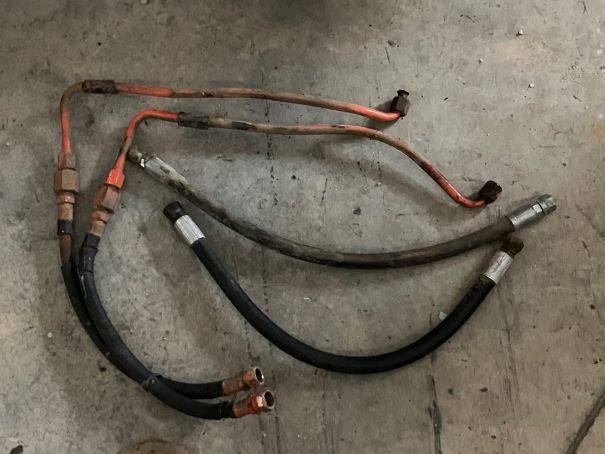

So it looks like (by the looks of the lines) that they go to the spools?

Take off the whole seat/seat track assembly and remove the shield underneath the seat. It will be pretty obvious which lines to remove (left side) and reinstall new (left side). Right side has lines removed and replaced with hoses only.

Post Options Post Options   Thanks (0) Thanks(0)   Quote Michael (WI) Quote  Post ReplyReply Direct Link To This Post Posted: 23 Apr 2023 at 3:32pm
This is what they came with.  I never saw them installed.

You have to use flexible hoses. I will try to get a picture later on.

My 185 has rigid mount couplers and I just bought breakaway couplers.  Can someone show me how they are plumbed?
