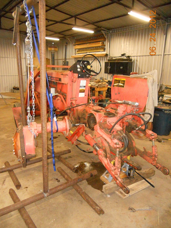

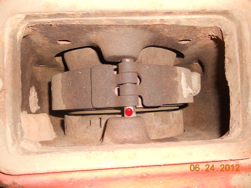

The steel panel around the seat base is handy to have off if you have brake pins that are difficult to drive out. On my tractor, one brake band pin slid out easy, but the other side took several hours of work before it freed up. I ended up needing the seat access panel removed so that I could cut the pin and brake band from the top. You will hate the design if you get one that is tuff to pull. A pin having 1-7/8 of solid tight tolerance steel to pass through is not my idea of a good design plan. Thats probably the worse part of the whole procedure of changing brakes. That and having to move the hydraulic bank up and out of the way to pull the axles. Good Luck!
Stubborn Brake Band Pin :(
A Last minute "throw together" axle hoist. Worked very well!
