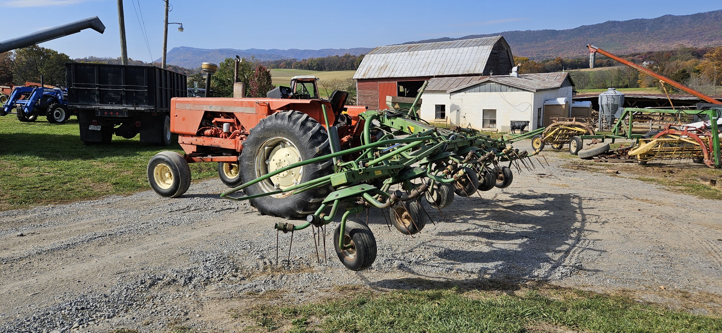

Hey guys, this is something I've not really considered before, but am looking at a 3pt tedder and want to use the 185.  Was told the tedder weighs 2000lbs.  I think it'll be fine, have fluid in front tires, no cast up front.  Looked at the dealer literature from when the tractor was bought new, and it doesnt say..   thanks, Wes

Post Options Post Options   Thanks (0) Thanks(0)   Quote Wes(Va) Quote  Post ReplyReply Direct Link To This Post Posted: 29 Oct 2024 at 11:24pm
Update: it lifts the tedder with ease!  I can feel the frontend is light.  Haven't gotten it in the field yet.  Have weights that came off the rear axle on F2, just need a weight bracket to put them on this tractor, and it should help a bunch.

Post Options Post Options   Thanks (0) Thanks(0)   Quote Wes(Va) Quote  Post ReplyReply Direct Link To This Post Posted: 13 Nov 2024 at 9:10pm
Here it is!  I've never really been able to post pictures, but I think I've got it now..
