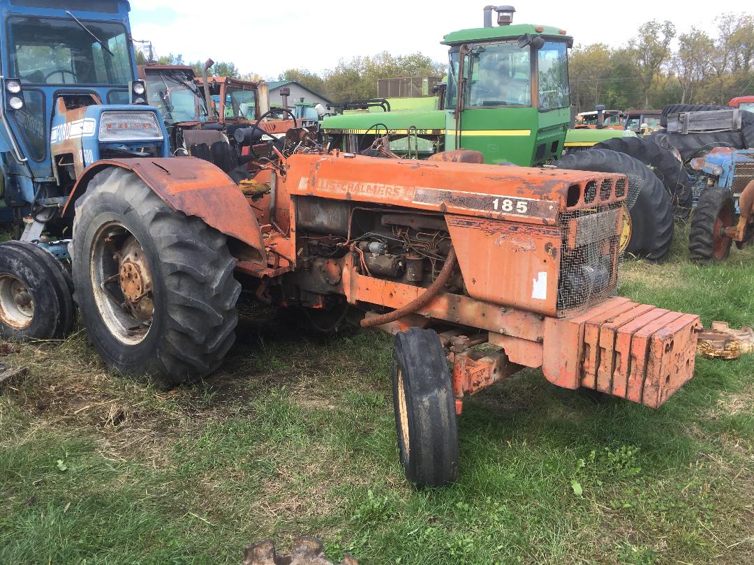

Found a picture on my phone. One at Colfax is a 185.

I think the final drives must be rotated forward one hole to lower it down in the rear.

Steve I believe they flip spindles upside down.
Are these rare. Iv never seen them around. But you don’t see them in to many collections

The picture I posted is at least five years old, not sure if that tractor is still there or not. This discussion has me curious. If I can just get free for a few to go have a look. Dr.'s thought about rotating the finals forward is leading my curiosity.

I think those front five weights are from a J.I. Case tractor ??  not Allis.

Is the muffler hole in hood blocked off.
Was there anything stamped into sr no for orchard tractors

Mike... i think your on to something... If you pull the Square Tube axle out of each side and flip it... it kind of looks like your photo above... that should drop it a few inches..

Doc, I'm not sure what they are. Looking at them they almost look like Oliver weights but maybe not quite. I've seen the Case weights you mention, not sure if that's right either? It would be nice if there were a Brian Ahart type site for each brand. If you look closely you can see the wheel weights I took off in the edges of the picture.

I have a White with one or two of those type weights. But a flame cut piece of 3 inch plate was added in front of the factor weigh. So I have never seen the front side of the factor weight. So the Oliver idea sounds very possible.

I see an original cast iron A-C wrap-around starter weight (approx 250 lbs) bolted to the front of the tractor. Then I see FIVE identical weights attached to the starter weight. Nothing flame cut. ALL cast iron. Oliver does sound better than what I thought was J.I. Case.

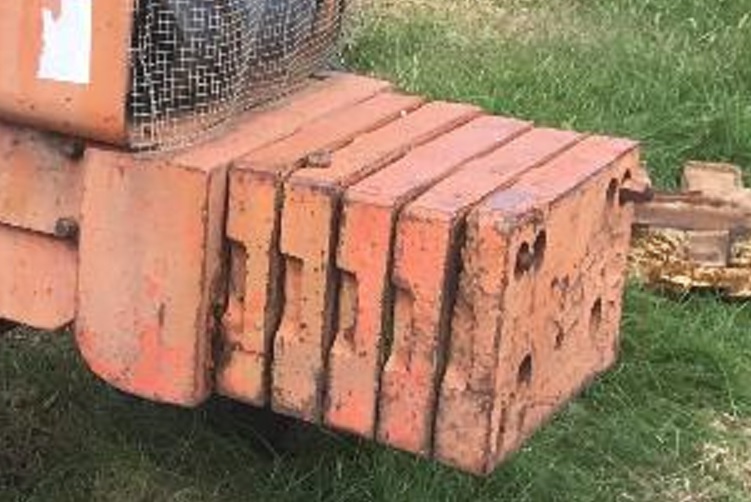

closeup

That is a whole lotta weight on the front of a 185 tractor !!!

After looking at some Oliver slab weights on you tube, going to say they are Not Oliver. Still curious what they really are.

Those weights are Allis Chalmers industrial like used on the rear of an HD-4 crawler loader.

I have a D17 diesel from California that has been lowered and the final drives rotated like this 185. Showed a picture to the late Norm Swinford who in my opinion was the ultimate authority on all things AC. He said that none left the factory that way, Large dealers in California would modify a new tractor to the customer's specs. A lot were J&M conversions. There was a nice 185 like this at the Nesbit sale in 2017. Friend bought it and modified it back to a regular farm tractor.

Thanks.
