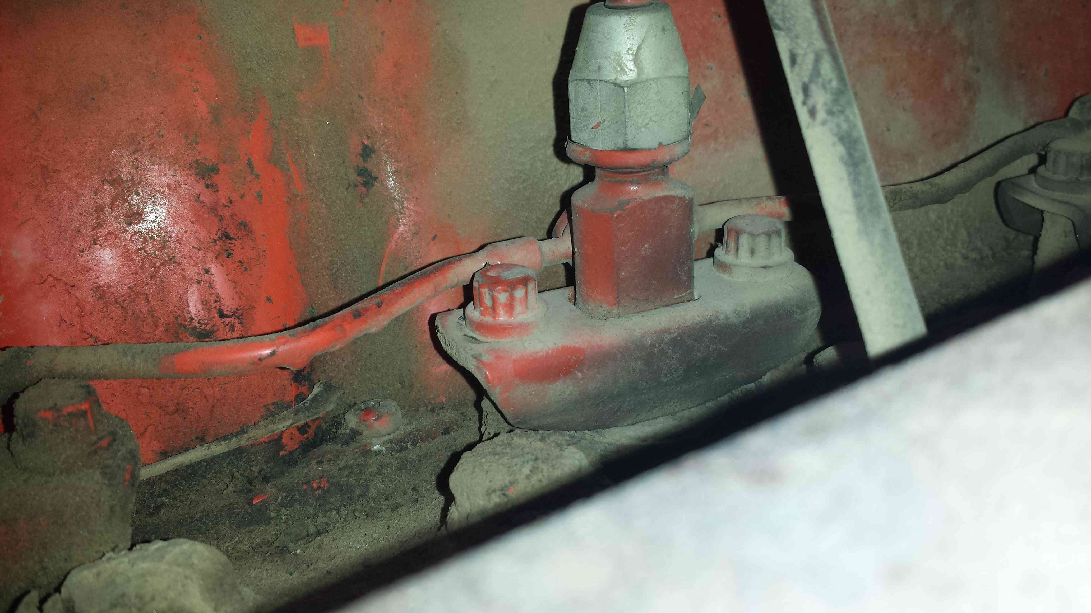

Just for reference, here is a picture of my father's 185, Serial number 15616.  These are the Bosch injectors.  What I've mostly heard is that this was a change that wasn't really needed at 185 horsepower levels but since all the engines got the upgrade at the factory, the last few 185's got them as well.

Thanks for the photo this has been a really cool discussion.
