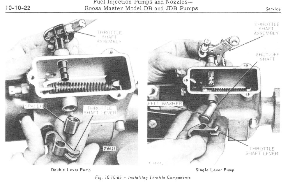

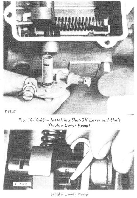

Not on the 180, but did this same repair to a Roosa on a Case.  They seem to be pretty notorious for this drip.  Its simple once you realize you have to pop that little C shaped clip off in the center of the throttle shaft and then pull both halves of the shaft out their respective sides.  That's the clip that Mack says don't drop.
I only mention this because after you pull the cover off, it isn't immediately obvious how that shaft comes apart.  And remember to clean the pump and surrounding area BEFORE you crack the lid because it becomes a wide open dirt magnet.

Post Options Post Options   Thanks (0) Thanks(0)   Quote Luke114 Quote  Post ReplyReply Direct Link To This Post Posted: 21 Jul 2020 at 5:55pm
Your video probably shows this better, but here's some pics from the manual.  Not the exact model, but gives you a good idea of what to expect.
