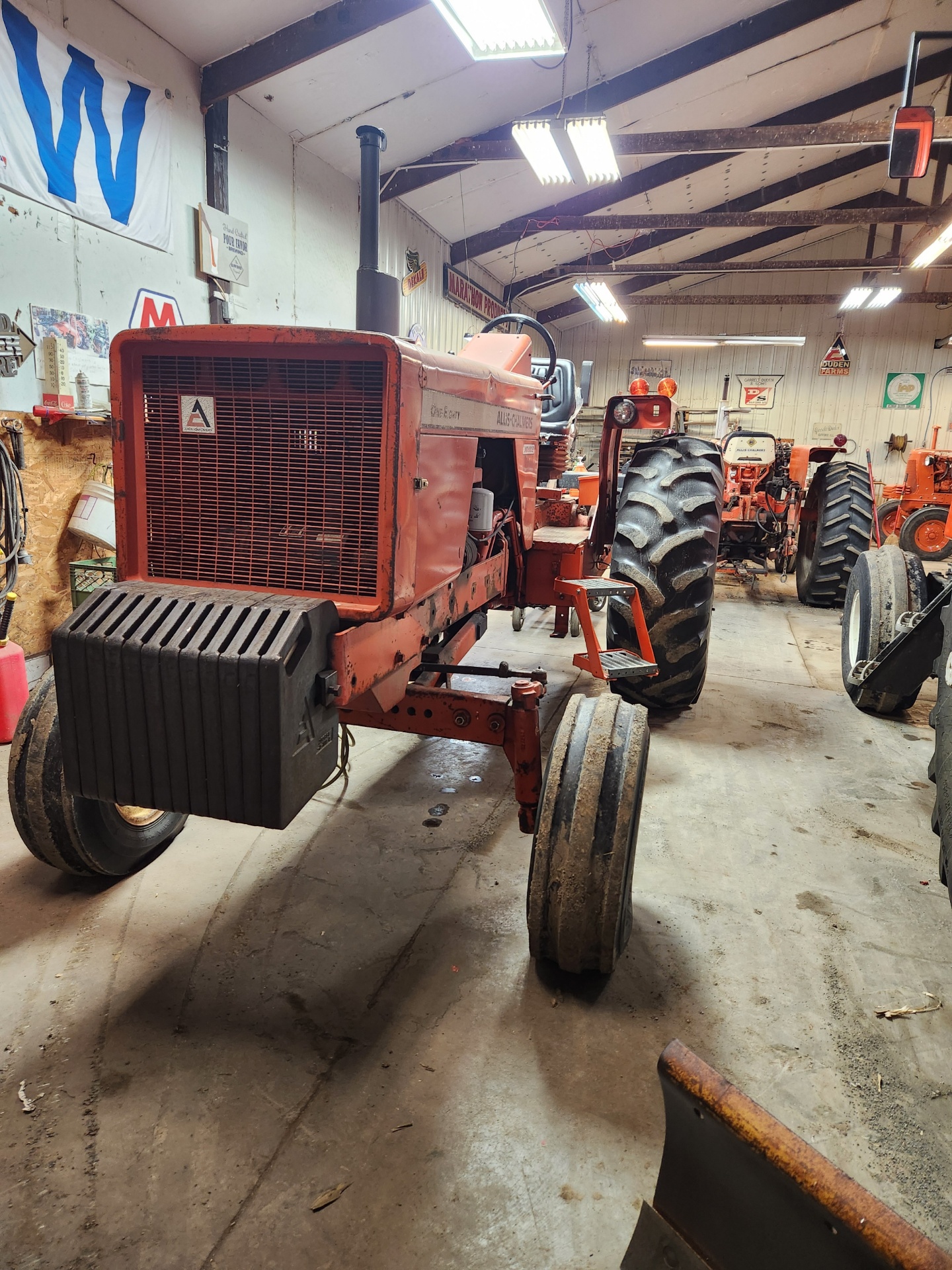

Painting my 180 and was wondering what color the grill insert should be? have seen white on some and some orange. Serial number 12162. Cloud white for front rims and rear wheel centers?

Looks like the grill screen was and still is orange. The hood decal was cream with black letters. Thanks for the info. Randy

I checked my grill today. It was painter orange from the factory, so orange with the cream decal on it. Thanks again for all the info! Now i just have to get it ready for the GOTO at Penfield this summer.

That kind of confirms too, that all those grills after 72 were the flat front shallow style. I've also noticed the new style is made of a slightly thinner metal. Always figured they found a different supplier.
Hey Randy, which style grill is yours? And you had it a long time, and pretty sure it's original?
Went and looked your serial, and yours is indeed a 72, so yes, it should look just like the brochure Dale posted. I have never seen a 180 or 190 with that grill ever, I know those post 72 tractors are out there, but we rarely ever see them lol!

It is like the literature on here. Trying to load a pic

Finally got a picture to load!
