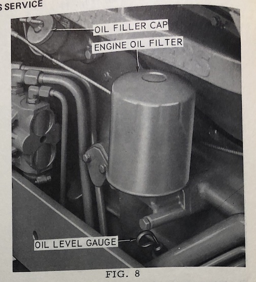

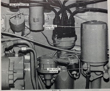

Post Options Post Options   Thanks (0) Thanks(0)   Quote AC7060IL Quote  Post ReplyReply Direct Link To This Post Posted: 01 Jan 2025 at 11:14am
AC 180 diesel 2800 dipstick in above photo.
AC 180 gas 2500 dipstick in below photo.
Photos display the height comparison of oil dipstick heights per each engine, courtesy AC One-Eighty OM form TM-458C.
