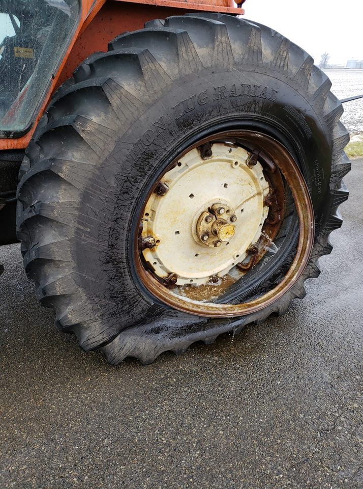

Had a little wobble on the 7045 today. When I stopped to see if I had a low tire, this is what I saw. Anyone have a good rim used or new. Send me pics, price and location if you have 1 or 2 for sale.

Yes but not close to you. Double bevel rims are very common and used by many brands.
Local salvage yard or new is your best option.

Man, that is a crappy day!

Calcium Cloride is the next best thing to sliced bread, isn’t it? One thing that is absolute when you have it in your tires, it’snot IF you rims will rust out, but WHEN.

Man, that's a BIG bummer....better get 2 rims as I fear the right will follow the left....
Friend has a Belarus, that had loaded fronts. One went..he buys one rim.....2 years later, the other one blew out. Cost him 3 down days and a 14 hr 'roadtrip' for another rim...
Do you really,really NEED them to be 'loaded' ?

Thanks for the pic!
Never seen that before!

Paul, it's not bad if it stays in the tubes. These tires were just put on. Tire dealer should have looked at the rims.

I have a pair of rims coming From Anderson Tractor, Bluffton, Ohio.

Got the rims in 2 days and they are lightly used. One looks practically new. The other I will clean up a little and paint it. The 7045 is back on all 4.

I've got an N ford here with the same problem, guy gave it to me to haul off. His dad bought it new, he could not remember ever having fluid in the tires. He came out the other morning and found it like that, said he was tired of spending money on it trying to keep it running.

The rusty rim is a problem but Radial tires put more pressure on the rims also. Ive known of a few radials with no fluid split a rim.
