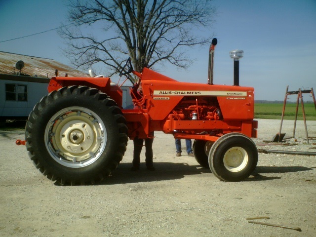

I think this is a picture from the Gubbels' ..I hope they dont mind..but it is a sharp 190..If I ever had one I'd want it to look like this one.   -Wes

I would say 18.4-38's is the way to go!!! They are harder to find with the 38's Here are a couple photos of some of the ones we have with the 18.4-38's.   THey will go right at or around 17 mph with the 38's.

Andrew, them are some very nice looking one-ninety XT's, thanks to all for posting the pics. I quite certain that by hay baling time next year, I'll some how or another have 18.4-38's on the rear and some pretty good sized diamond tread tires on the front of my one-ninety XT. I guess I'm too fussy, but I think I'm going to look for some different cast centers and everything (used of course) so that it looks original. However I haven't ruled out buying the step up wedges that Henry posted having for sale. Thanks, Darrel
