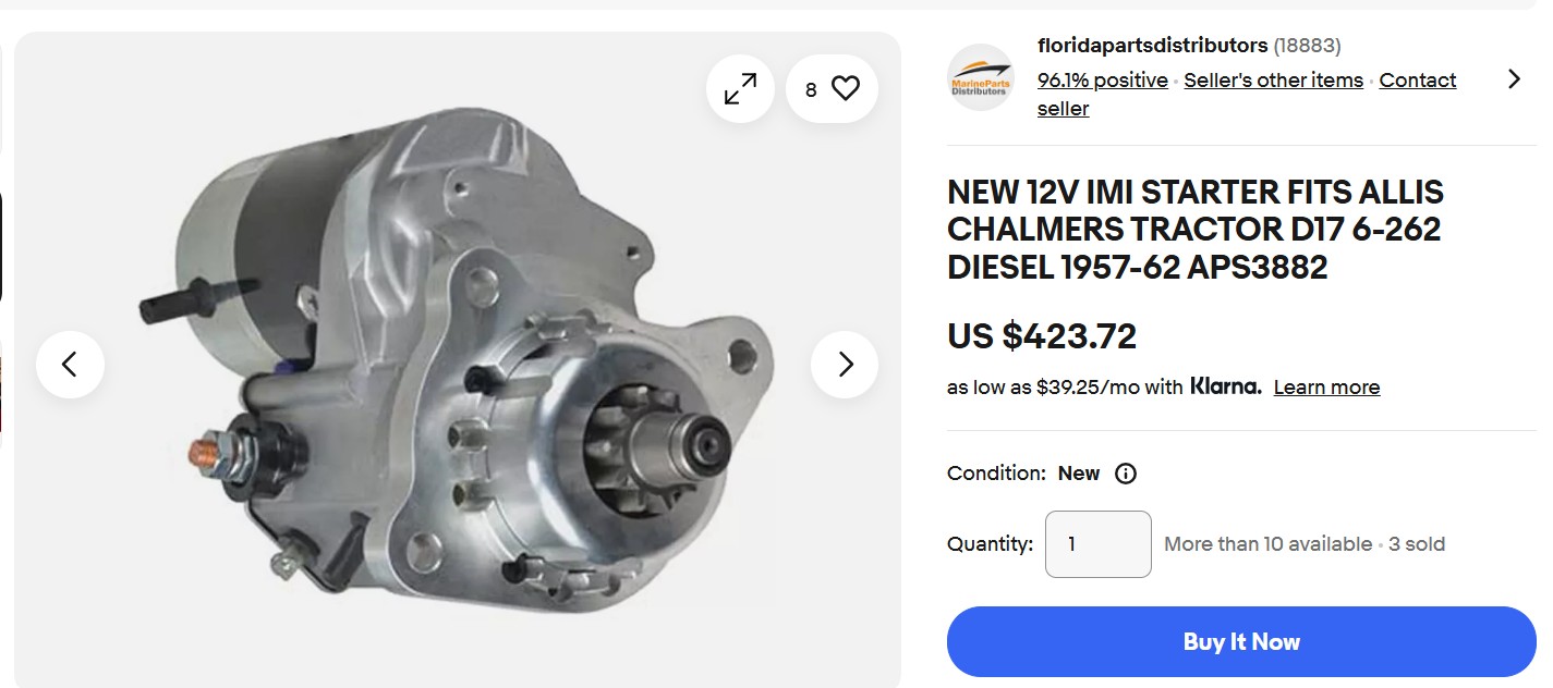

Dr Allis ? Does someone make a Gear Reduction Starter for a D17 Diesel ? Can you remove a canister oil filter base and mount a Spin-On base ? Thanks, Elvin

NEW IMI HIGH PERFORMANCE STARTER FITS ALLIS CHALMERS D SERIES 262 58-62 APS3882
$ 211.86 $ 423.72
Replaces Part Numbers & Specifications
ALLTECH: 104-3882 1043882
AMERICAN POWER SYSTEMS: APS3882
DELCO: 1113082
ITEM DESCRIPTION: STARTER
UNIT TYPE: DELCO
TYPE: OSGR
VOLTAGE: 12
ROTATION: CLOCKWISE
TEETH: 10
POWER: 2.5KW / 3.35HP
GEAR OD: 1.587IN / 40.3MM
MOUNTING EAR 1: 11.9MM UNTHREADED
MOUNTING EAR 2: 11.9MM UNTHREADED
MOUNTING EAR 3: 11.9MM UNTHREADED
Product Notice
As a parts distributor we mostly sell aftermarket parts (any OEM parts would be noted as such). Aftermarket parts are not sourced from the original vehicle or equipment manufacturer, but are designed to function the same as - if not better than - the original. All parts sold are new.

I've used those newer style starters on my Olivers,they'll turn the motor faster than the originals and seem to need less battery power.
