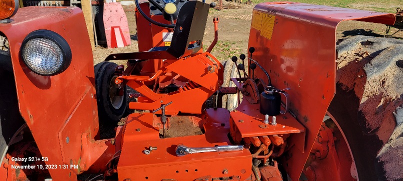

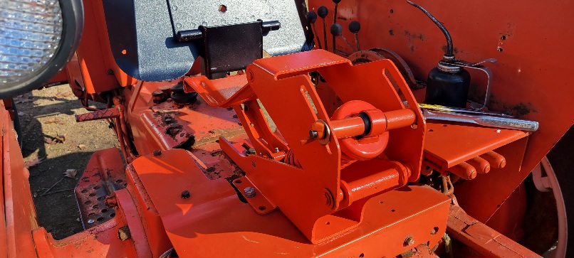

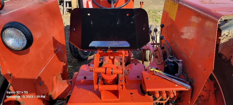

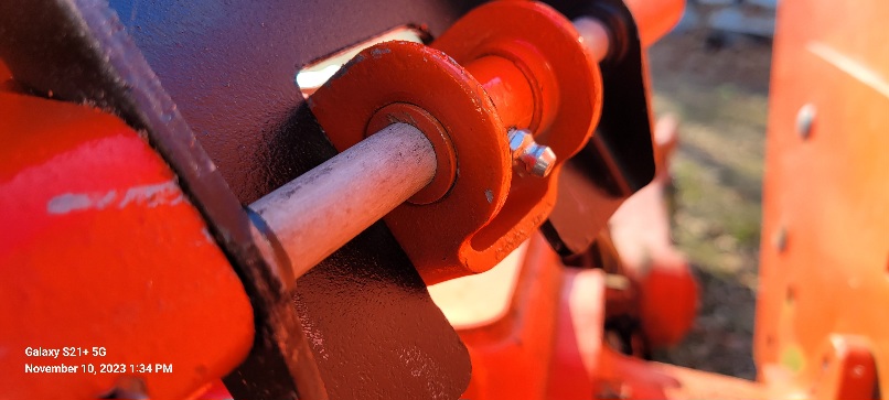

I know it's been months but finally have the seat assembly blasted and painted.
Now I need to buy cushions for it.
Any recommendations?

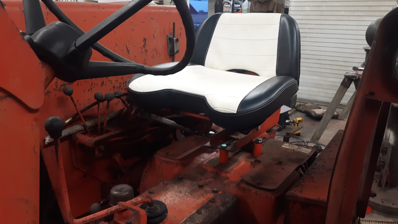

Got mine from DJs but all the holes did not line up. Still like it tho

Looks AWESOME!
I'll give them a try !

I like the extended spacers.

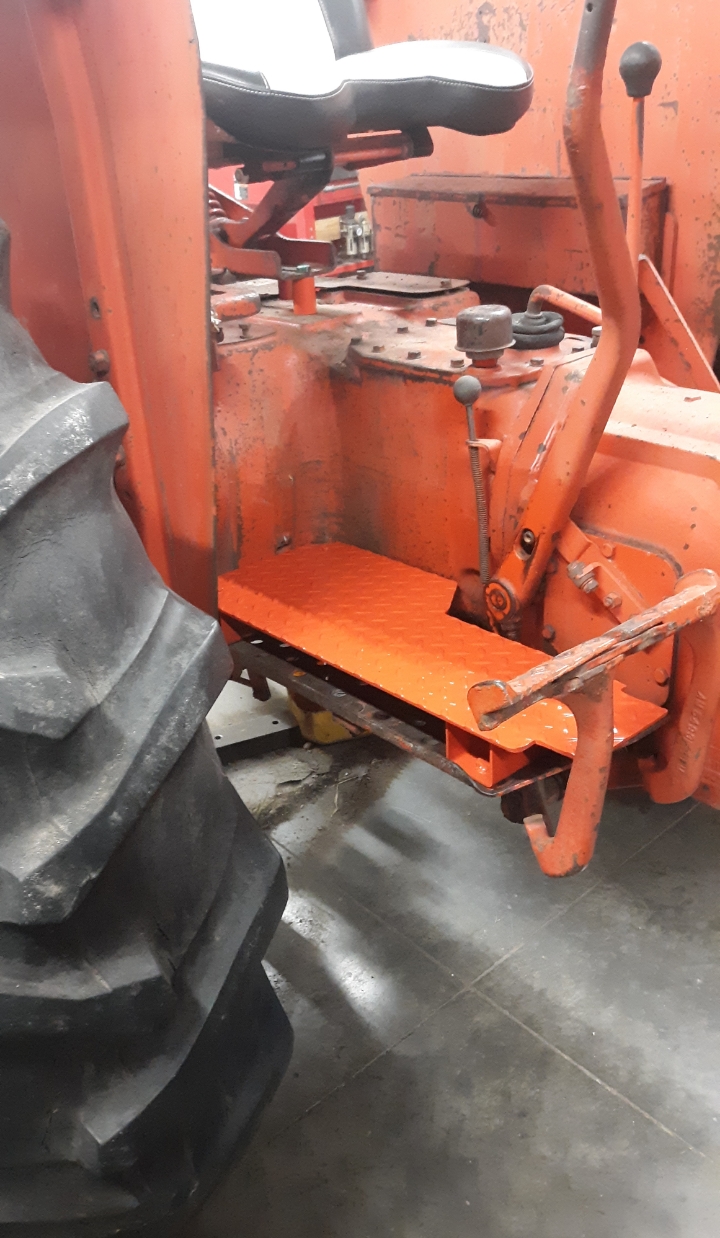

Platform tops match the seat spacer height.

Post Options Post Options   Thanks (0) Thanks(0)   Quote plummerscarin Quote  Post ReplyReply Direct Link To This Post Posted: 10 Nov 2023 at 8:24pm
Seat height is very comfortable now with the spacers and raised platform. The suspension has also been reworked. Before the Doc's work it would beat the heck out of me

Hey Doc
Not sure what platform height means ????

Points: 22800
Post Options Post Options   Thanks (0) Thanks(0)   Quote DrAllis Quote  Post ReplyReply Direct Link To This Post Posted: 11 Nov 2023 at 2:50pm
It really helps offset the high crown fenders and what seems to be a higher hood compared to a D-17. A good suspension that keeps you up off the bottom is the first start. I like my feet to just touch the platform when I'm in the seat for the best view on a 170/175.

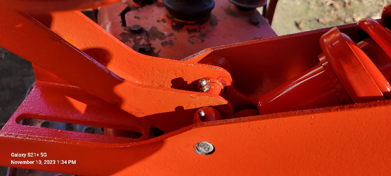

Post Options Post Options   Thanks (0) Thanks(0)   Quote Tracy Martin TN Quote  Post ReplyReply Direct Link To This Post Posted: 11 Nov 2023 at 6:34pm
You need to put a heavy washer as large of diameter as you can under bolt heads. It will fatigue  them holes in seat frame  on them spacers over time. JMHO, Tracy
