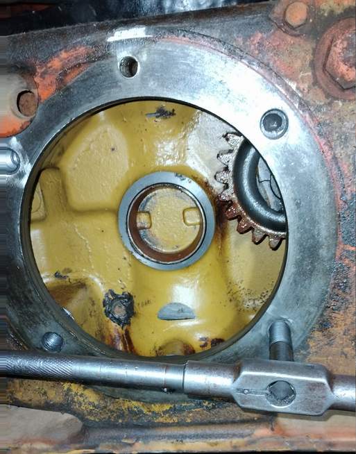

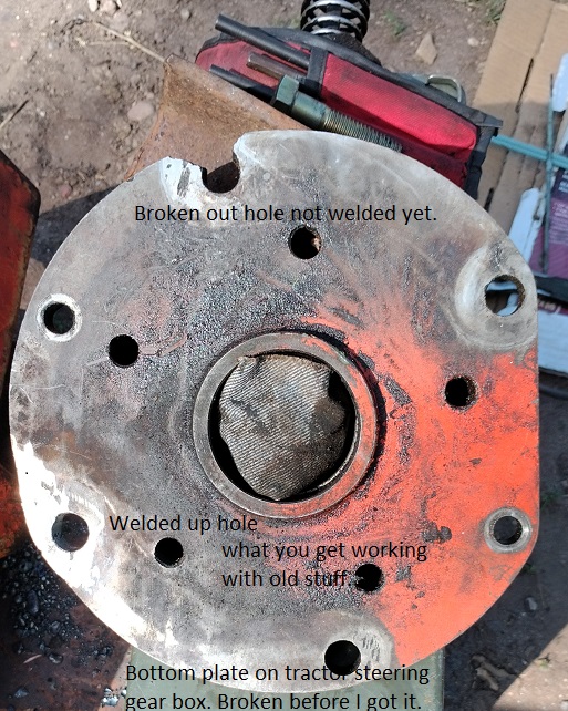

 The gear and splined shaft are held in by the cover which has shims between it and the steering case, held by 6 bolts, two hold the plate that has the lower race in it and the seal, and the other four holds the bolster and the plate.
 This plate/cover is on my tractor and in repair stage here. You can see seal  through center hole, race for tapered bearing sits above seal. had to weld in two holes because they were broken out. Yours won't be this bad, hopefully.
  The two 1/2 x 1 1/2 bolts are torqued to 90-100 ft. lbs.
  The four 5/8" x 2" are torqued to 130-140 ft. lbs.
And the axle rear pivot bolt torqued to minimum of 150 ft. lbs.

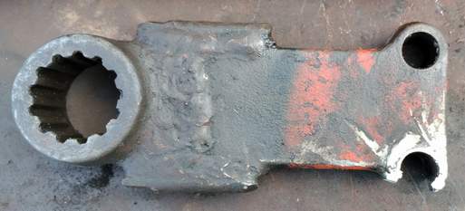

This is the steering housing /block. Looking up from underside. Center splined shaft (not shown) has gear on it and cone bearing that centers in race in block. Previous owner had gear off by one or two teeth and it would steer extreme right and couldn't hardly turn left,, so keep your timing in place when taking apart so it doesn't happen to you.  Had to drill and tap three holes and put in helicoils. Not so bad of a job  but put on some good sealer above 'o'ring on cover that slips into the opening in this pic..
  Don't know what type of monkeys were playing the day they repaired this tractor front end. but... you would think they would have gotten a better steer arm instead of welding tie rod to it.
 I did weld a piece into this arm and ran a tapered reamer into it so it is like original.

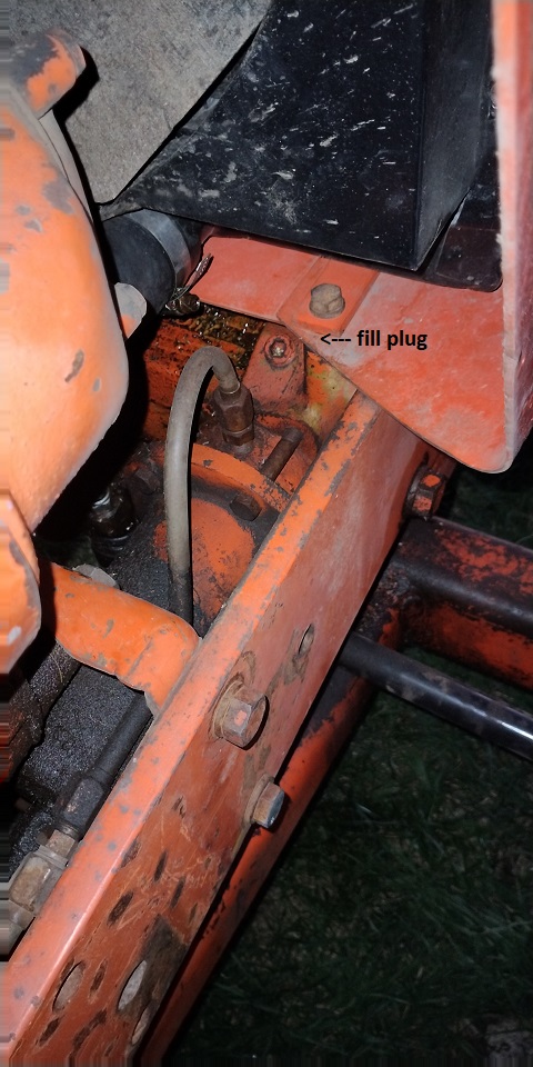

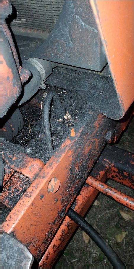

Ocharry, some things become disguised with age, an elements.
Can you find the fill plug?
Maybe I need to clean off the dirt some...
 Does that help in finding where to look?  Like I had said before, "Filler hole is above the steering cylinder, under the tin work that wraps around the radiator. It is an allen plug and sits at an angle under there and can be easily seen when you know what you are looking at." just gotta look in the right place. LOL
 You could do like chrysler does for their auto trannies, they don't supply any method to check oil other than to pull a cap off and run a wire down to check the tranny fluid.

Thanks JC for the pics. I had no idea that fill plug existed.

While we're on the subject, does the D17 IV with wide front end have the same hex plug as the 170?  The only oil filler I have seen is the tall one in front of the radiator for adding ATF for the hydraulics.  Is there a separate plug for gear oil elsewhere?

see right there...i did see that plug on mine but i was looking for a bigger plug..lol...yeah my old gal aint quite as dirty as the first pic you show....maybe about like the second one...so that little plug was easy to see...and i said to self....that cant be it...to small and in the wrong place.....lmao....but ill be dang that was it ....good thing it wasnt a snake...yeah i was looking for a 1" or so plug

  Old Wrench, No plug there on a D17 like on a 170.
The casting under the radiator on the D17 IV is just for power steering only - nothing else.  Remove the breather and use ATF or hydraulic fluid.  The reservoir for the hydraulic system is the torque tube.
