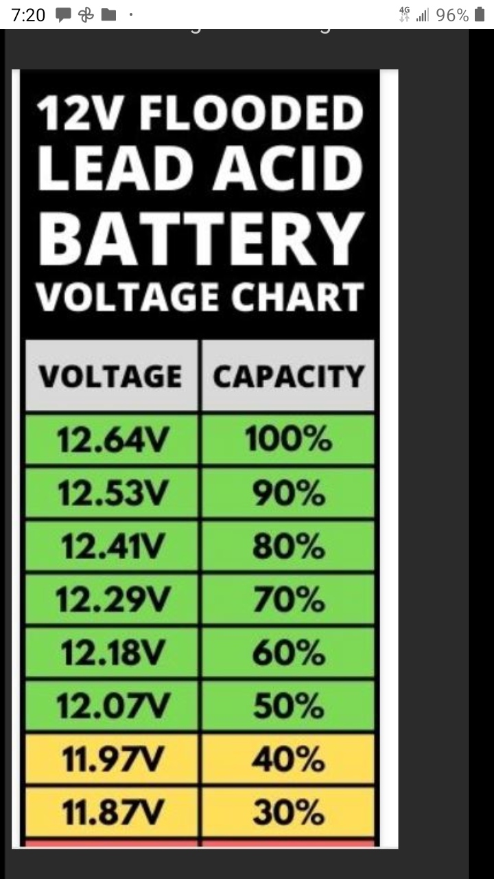

Post Options Post Options   Thanks (0) Thanks(0)   Quote Tracy Martin TN Quote  Post ReplyReply Direct Link To This Post Posted: 16 hours 56 minutes ago at 6:02pm
I charged the battery up. Only shown 11.74 volts on my meter. Hooked it up to tractor, tried starting it, only would buzz the solenoid. Put jumper cables on it from truck, and it started. Pulled the battery out and going to have it checked out. During it running, it showed no charge at ammeter. Unpluged the voltage regulator and re pluged it, still no change. Turned on lights and shows no charge. Voltage regulator is gray in color lid, riveted to base. What couls still be my problem? Any help appreciated. Tracy

Post Options Post Options   Thanks (0) Thanks(0)   Quote Les Kerf Quote  Post ReplyReply Direct Link To This Post Posted: 16 hours 4 minutes ago at 6:54pm
Originally posted by Tracy Martin TN Tracy Martin TN wrote:
I charged the battery up. Only shown 11.74 volts on my meter...
Is this the same battery that previously measured at 5.34 Volts? If so, it is toast Ouch
... During it running, it showed no charge at ammeter...
Hmmm... even with a bad battery the alternator should still attempt to put some charge current into it.
Worst case scenario is that you now may have not only a bad battery but also a bad alternator and a bad regulator. If it were mine I would test all three before replacing anything again.
This is one of those chicken or egg situations where it is difficult to ascertain what failed first.
Best wishes Smile

Post Options Post Options   Thanks (0) Thanks(0)   Quote plummerscarin Quote  Post ReplyReply Direct Link To This Post Posted: 15 hours 37 minutes ago at 7:21pm
I agree the battery is toast
You know what the voltage is not running. With the tractor running, disregard the gauge on the tractor and take reading with your voltmeter. Should be higher than your static (no pun intended) reading. A load test on the battery may indicate a bad cell
