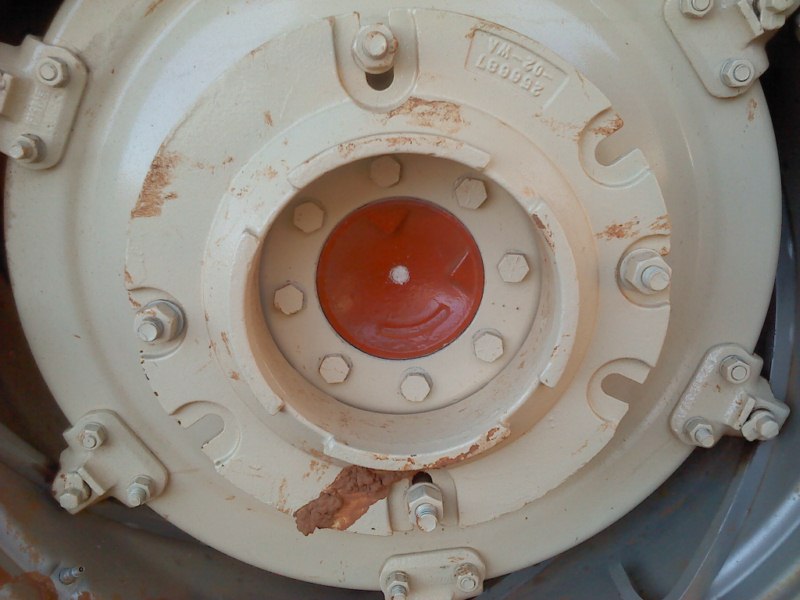

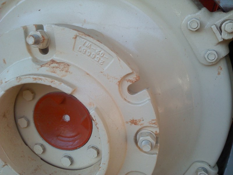

Looked at those weights on above AC175D tractor (photo), and the numbers are:  256687-02-WA      Are these Allis Chalmers?  or after-market?
Tracy, here's some photos up close.  Is this what you asked for?  Let me know if you want more?  thanx,
Bruce Odel
NC Bruce View Drop Down
Location: Mill Spring, NC
Points: 224
Post Options Post Options   Thanks (0) Thanks(0)   Quote NC Bruce Quote  Post ReplyReply Direct Link To This Post Posted: 15 Feb 2012 at 9:53pm
Points: 224
Post Options Post Options   Thanks (0) Thanks(0)   Quote NC Bruce Quote  Post ReplyReply Direct Link To This Post Posted: 15 Feb 2012 at 9:54pm
Location: Gallatin,TN
Points: 10832
Post Options Post Options   Thanks (0) Thanks(0)   Quote Tracy Martin TN Quote  Post ReplyReply Direct Link To This Post Posted: 15 Feb 2012 at 9:56pm
Bruce, they look like AC weights. Early casting had AM on them, I can't say on those. AC weights pictured in my book has 7 slots for bolts,4 grooves in register ring. How do you want to ship them. LOL Tracy Martin

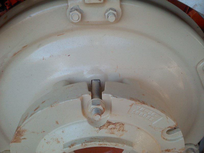

Chris/CT View Drop Down
Location: Niantic, Ct
Points: 1939
Post Options Post Options   Thanks (0) Thanks(0)   Quote Chris/CT Quote  Post ReplyReply Direct Link To This Post Posted: 16 Feb 2012 at 7:52pm
I have the Rowe style 300 lbs on my 175, do you want a pic??
Points: 10832
Post Options Post Options   Thanks (0) Thanks(0)   Quote Tracy Martin TN Quote  Post ReplyReply Direct Link To This Post Posted: 16 Feb 2012 at 7:58pm
Chris that would be great. Tracy
Points: 1939
Post Options Post Options   Thanks (0) Thanks(0)   Quote Chris/CT Quote  Post ReplyReply Direct Link To This Post Posted: 16 Feb 2012 at 8:15pm
Pic of weight;
