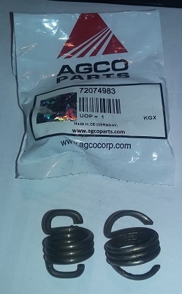

My 160 has had a history of having the right brake lock up when I touch on the pedal.  So, I ordered new springs and they are quite different from the original.
The spring on the left is the new one.  Notice the flattened shape and the metal is bigger.  they are a lot stronger.
I ordered 8 but just need two per side, so if someone needs four I will have them if I go to Booneville.  I am planning to be there Saturday.  859 396 1194
