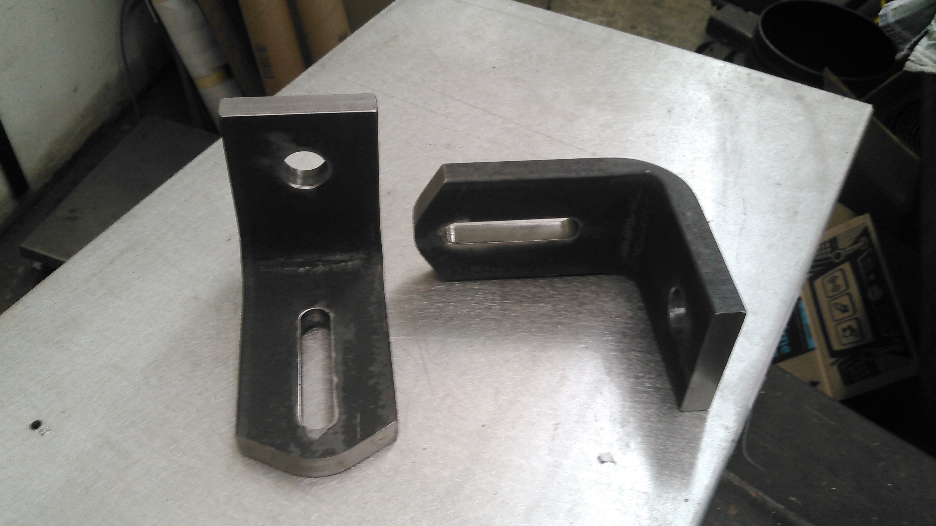

Posting pictures for Tracy Martin.

Sir
How and where do they bolt on a No 10 auger. What are they for. Can you send la picture. Thanks 785-353-2392

Post Options Post Options   Thanks (0) Thanks(0)   Quote Tracy Martin TN Quote  Post ReplyReply Direct Link To This Post Posted: 25 Aug 2018 at 3:42pm

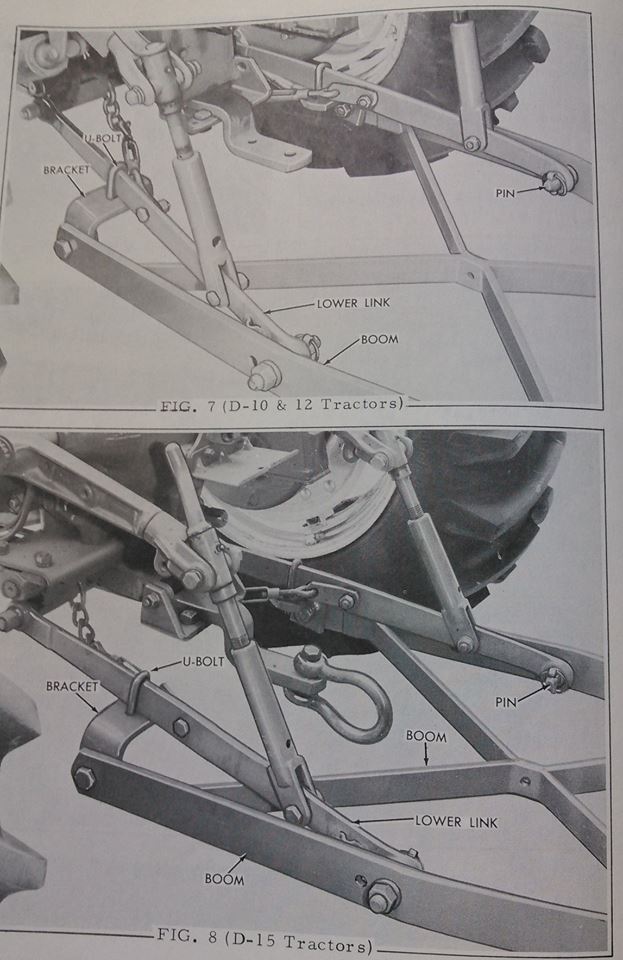

Been out of town today. The brackets are for the # 10 post hole auger. They are for 3 point attachment to the D10-12, and D15. They bolt where snap coupler bracket pivots. There is a u-bolt that goes thru slot and straddles 3 point lift arm. The ball in lift arm attaches to a pin in auger frame. I will see if I can get Charlie to upload a pic of it. Charlie, I sent a pic to you of how they work. I can't thank Charlie enough for helping me out, couldn't do this without him. Thanks Tracy

 Ray, sent you a pic. They covert the snap coupler to 3 point on the D10-12 and D15. Thanks Tracy
Post Options Post Options   Thanks (0) Thanks(0)   Quote CTuckerNWIL Quote  Post ReplyReply Direct Link To This Post Posted: 26 Aug 2018 at 12:33pm
Here's a picture of what they do.

I have a few sets of these extra I made up. They look like originals, except machined instead of die cut.Makes using the auger a lot easier.  125.00 a set plus shipping. Thanks Tracy
