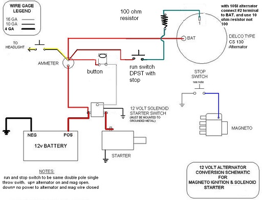

Mel, i use the 3 wire CS130  alternators on my tractors. The "light bulb" goes in the SIGNAL WIRE to drop voltage slightly and make the alternator start to charge. Instead of a BULB, i use a 100 ohm resistor. These are about 1/2 inch square and 3 inches long with a wire out each end.... I bought several at Radio Shack 15 years ago about $1. each.....When i used the 10SI alternators, i used a 10 OHM resistor.
this is the diagram i use... I have a double poles switch to turn the alternator ON and UNGROUND the MAG at the same time... If you have a COIL, you want to turn the ignition OFF and the alternator OFF at the same time.. same switch..
Edited by steve(ill) - 18 Feb 2022 at 9:09am

Steve-   thanx for the great info, wonderful to have a person like yourself, I will be using this for  wiring project

Years ago i got a drawing from the DELCO BOOK on test procedures for the CS130 alternator............. this is how i came up with the "100 ohm" resistor value.
Points: 93506
Post Options Post Options   Thanks (0) Thanks(0)   Quote steve(ill) Quote  Post ReplyReply Direct Link To This Post Posted: 18 Feb 2022 at 9:33am
100 OHM, 10 WATT resistor ....

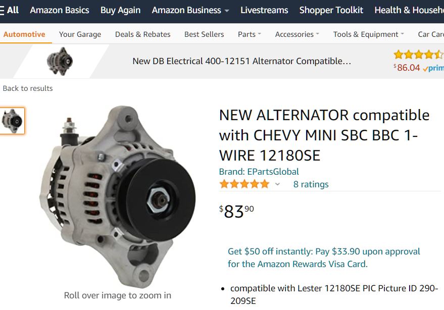

Here is the "ONE WIRE" the guys are talking about... Just GUT everything and one 1 wire to the POSITIVE battery wire.
Thinking of tossing one of these on 185 and be done.  Simple like trucks ran for years just less amp and money.
