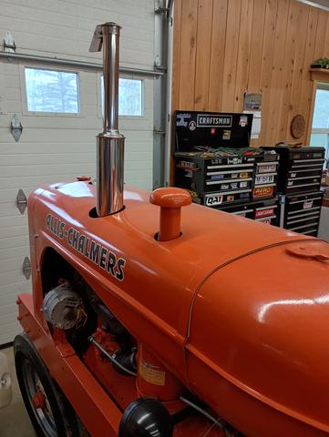

Thinking of hooking to the 3 bottom plows for May 9 plow day at our local tractor show. Then we have a pull on May 16 too. The guys will be rolling over about 30 acres if the weather is good.
I sprung for some exhaust stack bling on the WD45.

Nice looking chrome muffler you have there, really help set the paint job off.
