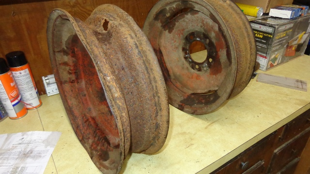

This is what the Allis front rims looked like prior to blasting. Probably the original rims for this WD45.  Almost matching rusted out valve stem holes. They are pretty rough but with some attention should be able to be put back in service.

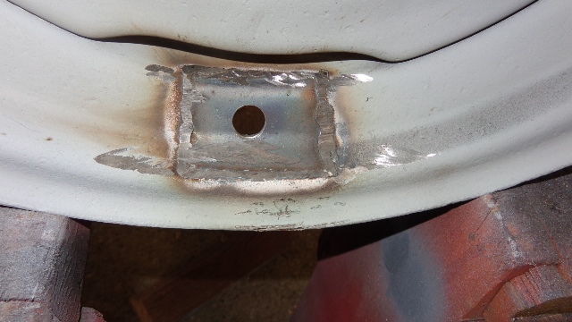

Folks,

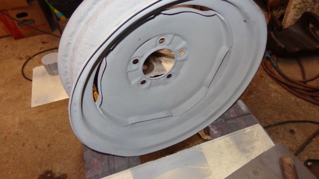

Have the worst front rim patched. its far from perfect but the whole rim is not really very good lots of rust pits in the inside. i think it will be fine with a tube in the tire. Was trying to get these done to get the tires mounted Friday afternoon when I go to get my truck tires changed. Not sure I am going to make it.Just running out of energy! whipped!
This was a challenge in metal work as the 4 inch long rim patch had to bend some  in both directions. i got it close with a ball peen hammer.:)  Mig welded the patch in place.
Will try to get a picture up.

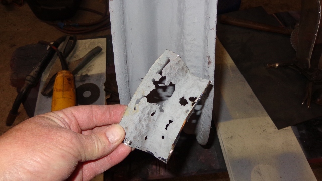

Folks,
Worst Allis front rim with patch in place. Have to drill the hole for the valve stem. I think I am going to drill it in the patch since its probably the best material on the outer rim. I used .060 thick sheet for the repair. (Big thanks to Andy at Edinboro industries for the piece of steel!)
Repair is at the 6:00 position (bottom) in this shot.
Picture of the rusted section of the rim cut out. Repair is directly behind it. (smooth portion of rim!:)
Repair came out OK. My metal skills leave something to be desired. A vice and a large hammer are pretty crude to form this type of heavy metal.
If i get ambitious I may get the other one repaired today. (I need to buck up a little anyway!) Then to the paint booth, for some silver on the rim and cream in the centers. I know a WD45 had P.O. colored wheels! Always someone that doesn't follow the rules!

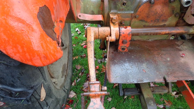

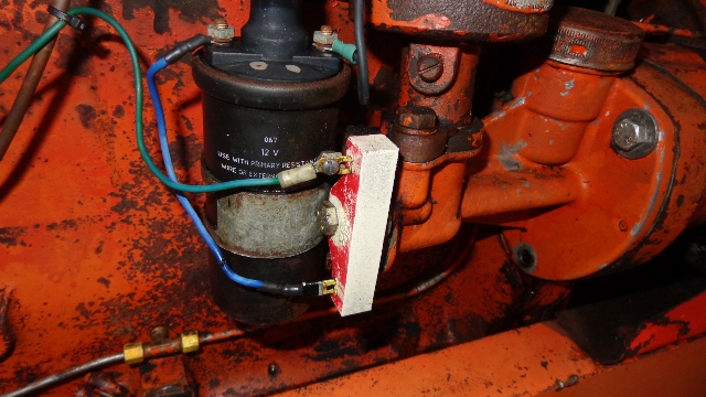

 OK back to some serious WD questions! What is this white electrical item vertical by the distributor? My first guess was a ballast resistor? If so why? It has been converted to 12 volt alt. has a 12 volt coil. In my brain it should not need this? Headlights are not to be found? Any way this is on the list to go unless someone has a real good reason. Maybe was for 6 volt lights??? Maybe this old coil did not have a internal resistor or something.

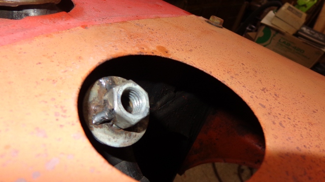

Here is where I welded a washer to the steel plug at the thermometer port. then a hex nut. the heat loosened the joint and I turned this out with out damaging the fitting for the thermometer.
Lift arm is bent I have never seen this before! i have a good set of lift arms from the parts WD that I may swap over to here. will function as is but I just hate seeing stuff like that! Also have good straight step pan from the parts tractor. Good thing I didnt scrap that old WD frame and rear end yet!
Both fenders have been crunched too. So if I feel foxy someday that's a project to get those looking good again. I think they can be saved. will just take some time in the body shop.

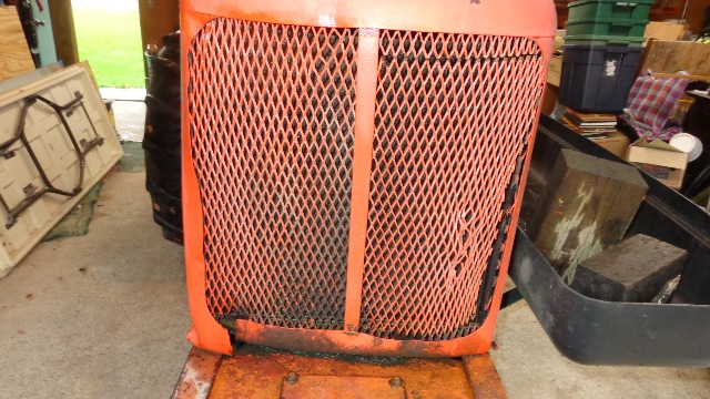

This grill may be able to be saved. The one I thought was close by fell through.
I have seen and worked on worse. The scree can be changed on both sides and the bottom needs much attention. Of course the side with the alternator has been cut. Why do folks do that? I converted three WDs to alternators and never cut one of them. So that swooping flange would need to be added back on the left side. both lower grill corners have holes and tears. Of course some dents and surface pits. This came from another tractor. The deep gouge on the right side of the hood indicates that what every did that took out the entire grill too.

That is a ballast resistor, Chris. It's used when you have a 6 volt coil and a 12 volt system. No doubt the lights were removed since the lamps would have blown almost immediately. Theoretically you can put a ballast resistor on the lights, but you'd want to put one resistor on each light. Otherwise if one bulb burned out the other bulb would suddenly have extra voltage applied to it. Those resistors would have to be of substantial wattage also. It's best just to replace the bulbs with 12 volt ones.
Points: 8689
Post Options Post Options   Thanks (0) Thanks(0)   Quote Sugarmaker Quote  Post ReplyReply Direct Link To This Post Posted: 03 Nov 2017 at 7:06am
Doug,
 I thought it might be a ballast resistor. But it has a 12 volt coil not 6? And the resistor seems to be hooked up? Where is Gearld J or Steve (B&B) when we need them? They love this stuff too! Anyway this will have to be looked at. Right now the tractor starts and runs fine. Has a amp meter which vibrates a little on start up. I haven't put a meter to anything on the tractor yet. Some days I wished I would have studied electrical instead of drafting!:)
So this is on the list but down there a ways and doesn't seem to be affecting the tractor running. Battery must be charging some, because I have not had to charge it yet.

I have seen a couple of lift arms bent too. Always think, how in the h... did they do that!

Probably a 12 volt coil, but have the correct internal resistance. Remember the 1970's Mopar engines. They all required an external ballast resistor.

I'd just buy a new 12v coil with internal resister to help clean it all up a little.
Chris,
I don't know what voltage that coil is. You can put an ohmmeter across the two terminals. If is measures under 2 ohms, you have a six volt coil. If it measures over 3 ohms you have a 12 volt coil.  It's not a big deal. I'd bet that is a 6 volt coil. The previous owner wouldn't have bothered with the ballast resistor if it were a 12 volt coil. If it works, leave it as is.  BTW, you can tell if the alternator is charging by measuring the battery voltage while the engine is running a bit above idle. It should measure around 14 volts.
Edit: I think it says 12 volts, but under the 12v and I may be imagining, but I believe it also says "use with resistor."  That makes it a 6 volt coil, regardless of how it is labeled.

 Your probably right on the coil. I may buy a new coil as mentioned to clean that up.

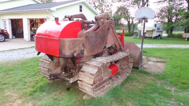

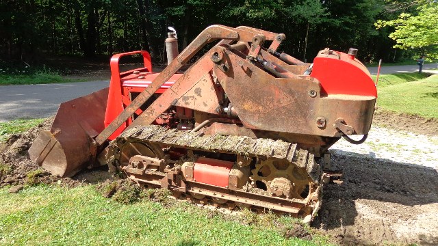

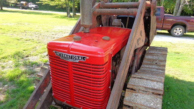

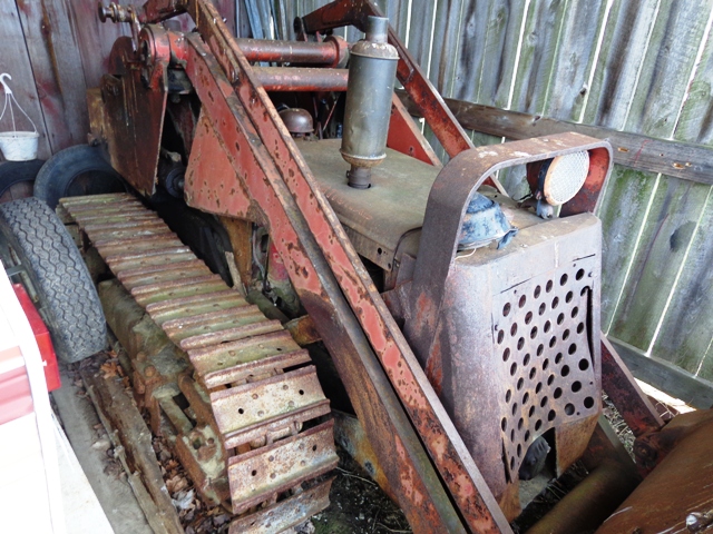

Claus, Folks

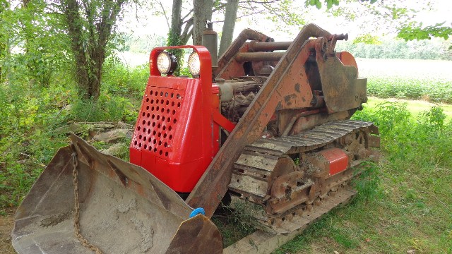

TD6 as found on the farm: Had a lot of issues:
Starts on gas then switch to diesel.
TD6 this fall:
Improving the drive ways.
another shot, working on lights. This was a partial clean and paint with 80% staying with original patina:
another from back, again only portions cleaned, repaired, painted. Electrical up graded.
This has been a very interesting project. Everything is bigger and heavier! it weighs close to 12000 lb.
Here is one with the big rock guard off. grill was in bad shape. a little buffing on that too!:)
Edited by Sugarmaker - 03 Nov 2017 at 10:25pm

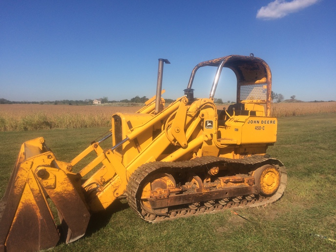

I recently bought a Deere 450C, something in the transmission broke after owning for a month.  Now it's in my Uncle's shed, winter project.  I understand what you are saying about bigger and heavier.  My machine weighs 14,000 pounds before the 4 in 1 bucket.  My tracks and under carriage are in good shape, I had loosed the tracks a little too much in this photo but corrected that before the transmission broke.
Edited by Claus - 04 Nov 2017 at 1:03am
Points: 8689
Post Options Post Options   Thanks (0) Thanks(0)   Quote Sugarmaker Quote  Post ReplyReply Direct Link To This Post Posted: 04 Nov 2017 at 1:33am
Claus,
What keeps you up at this hour?  That machine of yours is similar animal to mine. But your 4 way bucket makes it very useful. Hope you can get in and out of the transmission project with minimal cost and effort. These tend to be money and time time sponges! I got my 2 hours of sleep now about 2 hours up walking/ standing. Then we try it again.

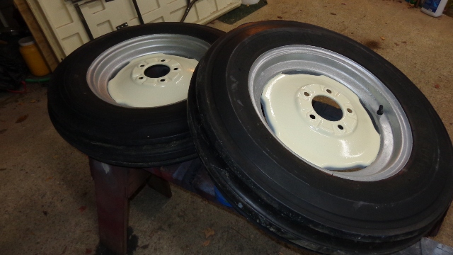

Back to Orange.
 I did get the centers of the wheels painted cream. Actually Rustolem Antique White. I like that color, Looks like real "top milk" for you old dairy farmers out there!:) It may not be close to what Allis used on the D series tractors? But the wheels will look OK. So I need to clean and paint the hubs P.O. and the lug bolt to get the total effect. One hole is stripped out on one hub and there was a bolt in there. I may reuse that same bolt till I get a new hub ready. Have a spare hub, that I found in the vast warehouse, but need to look at it for wear in the bearing race seats. Yea I have a pictures but haven't got them loaded to computer from camera yet! Slackin!
Edited by Sugarmaker - 04 Nov 2017 at 1:38am

Ok very exciting wheel pictures!
Patch at rusty valve stem area, on rim #2.
A little silver and cream on the repaired rims, with old tires mounted over new tubes.
I think we are almost back in business. Not perfect by any means, but should make the old girl feel a little better with some lipstick on. :)
FYI total cost on these old rims/tires so far is about $30 each. Tubes were 12.50 each and the blasting was $10 each. Labor to mount them, and some paint I had in stock.  The one tire is not real good, age cracked, but will have to due for a while.
