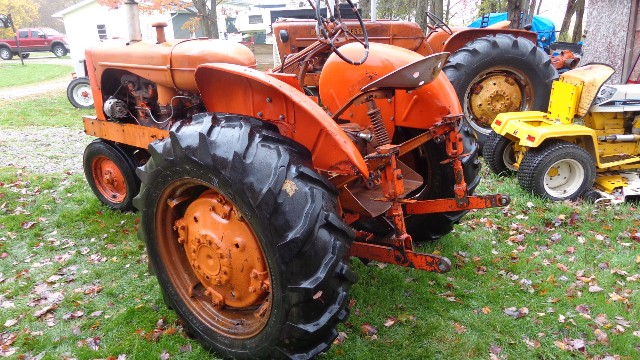

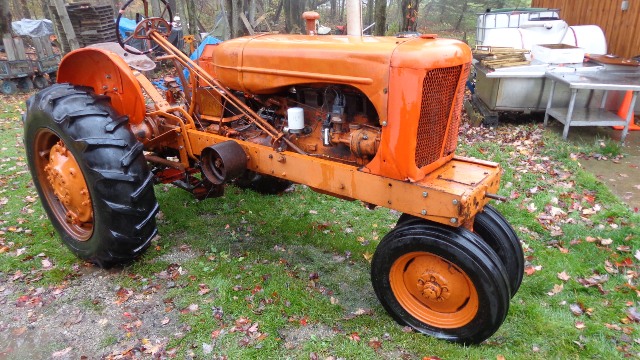

a old 45 in its work clothes.
Yes some rim repairs required someday.
washed the crust off and a lot of grease on the engine. (Note to self: must put a tapered lock pin and nut on the pulley on the crank.)
Grill has issues, talked to a farmer about 5 miles from me that may have one for sale.

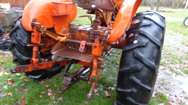

3 point should work well for brush hog.
carb side: I took the lights off the WD so they will be retrofit to this 45. That probably saved me at least $75.
Sorry for the blurry pictures. Just not running on all cylinders today!

I think you made a good trade and a good story. Nice that the other guy got your WD and is happy with it.
Other than that front grill it actually doesn't look crusty at all!
That 3-point looks just like the one that my 45 came with. It always worked good and was strong. It's off now for all my snap coupler implements.
It'll be fun to see how it compares plowing and such to your D17 and WD's.

I forgot to mention, that 3 point looks like an A-C factory one.  That's worth at least $300 right there.
These were regaled as the 4 bottom plow tractor, and when I pull my 3-16 I don't even know that it's behind me.  You'll LOVE it!!

This is what my 3 point was. That big bracket in the middle with the 3 tabs on the left and right. Some how the lift arms would hit on the sides and sway control. I took it off and painted it in 2009 and never put it back on. SO I don't exactly remember how it all went now.

Folks getting a list of needs for the 45.
I have to find a new air cleaner cup. mine is patched several places and is too bad to fix.
Who ever mentioned about checking the air cleaner mesh was on the mark Its a disaster! Probably why the carb to air box hose was gone. Its so plugged with watery looking oil, not sure the tractor would have run well at all.
The drain in the bottom of the rad was plastic screw. Replaced that with a correct brass pet cock.
the hole where the temp gauge goes had a steel plug in it. I welded a washer on that, then a 1/2 inch nut. this provided the heat to break this free without damage to the radiator neck inlet. Will order a temp gauge.
Drained the radiator and block. installed a gallon of antifreeze plus a gallon + of water to get near a 50-50 mix.
Realized that the tapered screw in the crank pulley is broke off in there! So that will not be fixed unless the engine is tore down;.
Added the brake pedal spring for the right side. Need to find correct brake spring for the left pedal.
Got both front rims off and took to shop and de-mounted. Rims are rusty and need the holes welded up and also straightened too.
So on we go.
A couple pictures using the green tree method of loading.

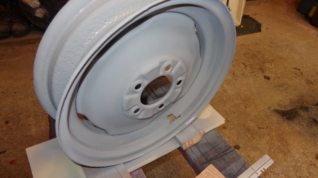

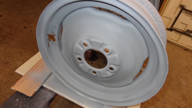

Folks,
The blasted and painted front rims:
Wanted to get some primer on them even though they need repairs around the valve stem holes. I will probably relocate the valve stem hole and then weld in patches.
