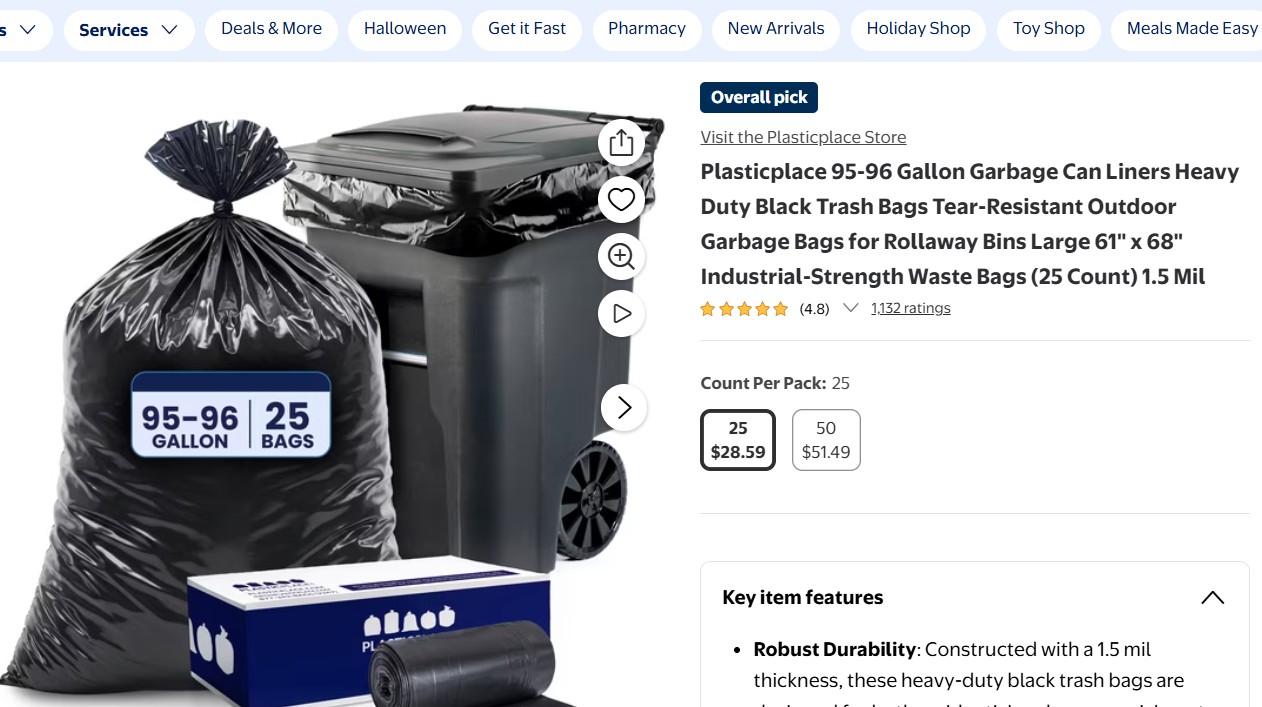

get the 95 gallon bags... fill and use the vacuum to pull out the air... cheap and easy.. this is Wal Mart... little over $1. a bag.
