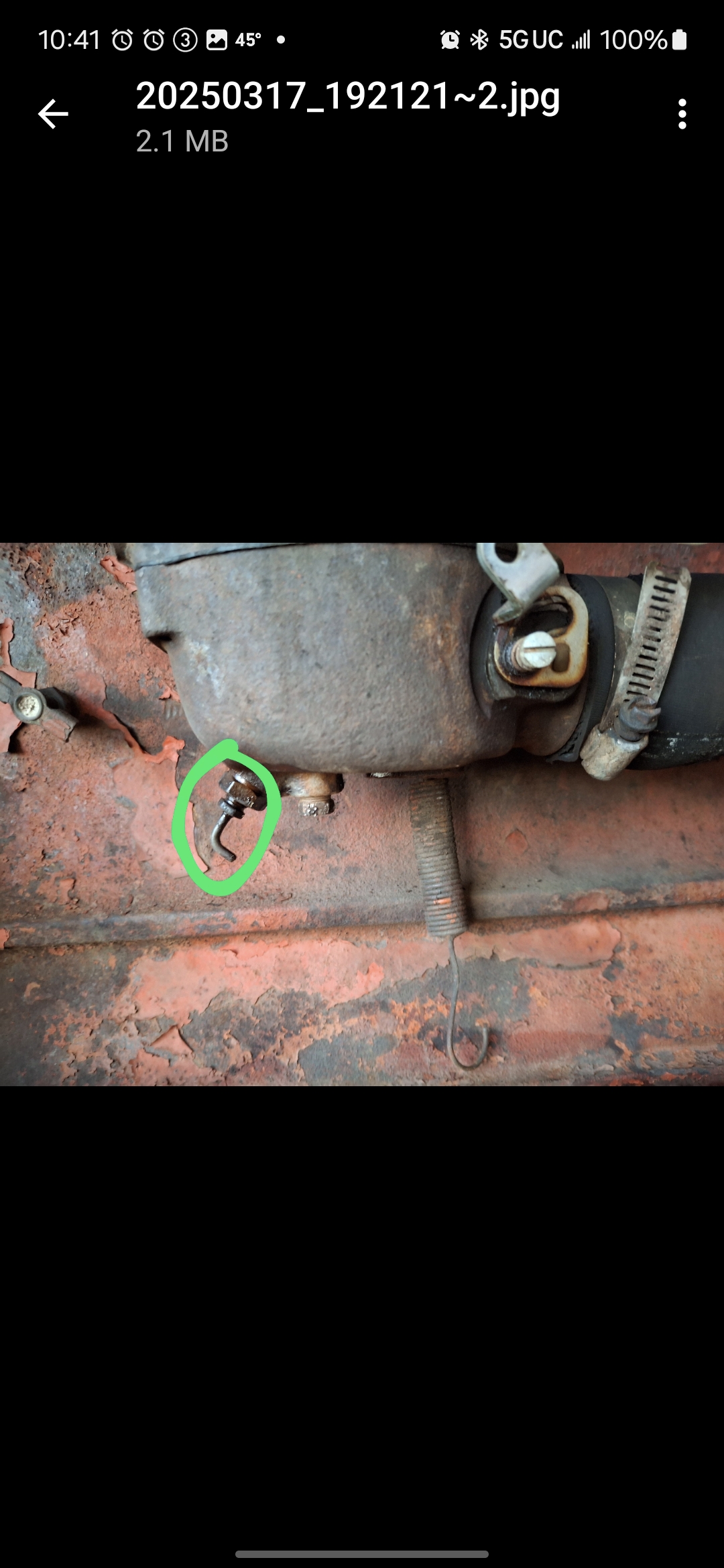

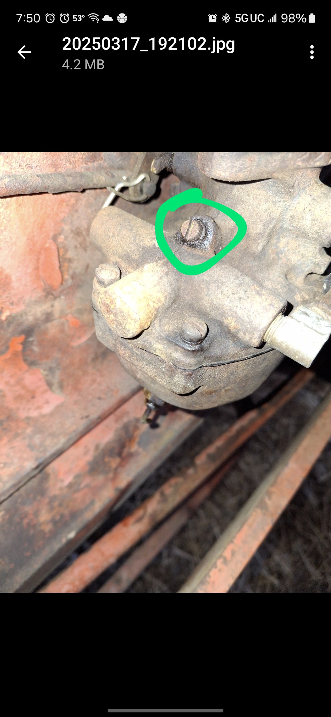

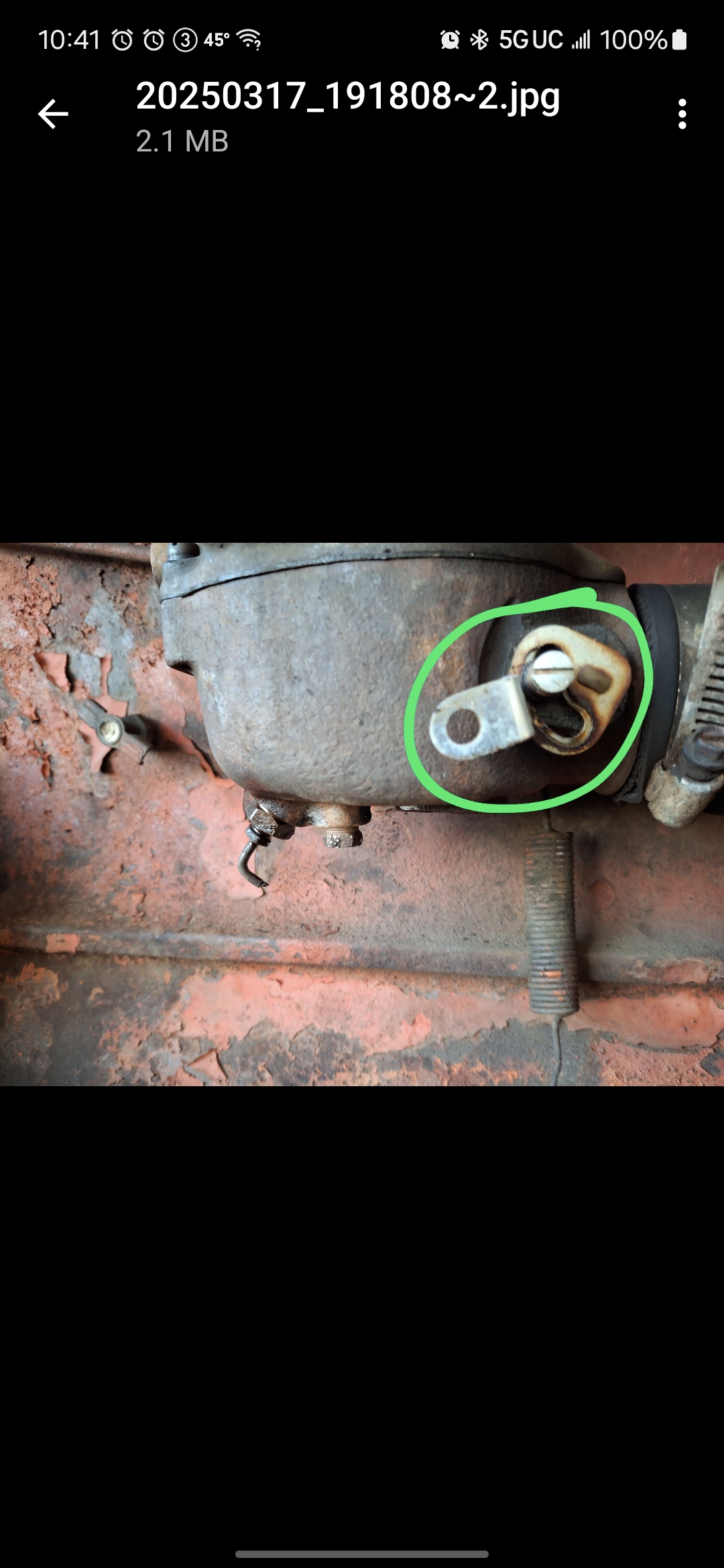

I was able to upload them after doing as you said.
Okay so I will just turn the L-shaped screw circled in green counterclockwise 2 or three turns out correct?
The second photo with the choke arm circled in green is where it runs great.

Post Options Post Options   Thanks (0) Thanks(0)   Quote steve(ill) Quote  Post ReplyReply Direct Link To This Post Posted: 18 Mar 2025 at 9:47am
yep... thats the screw... but also possible a chunk or rust is stuck INSIDE on the jet.
might also check that you have a GOOD SUPPLY of gas going into the carb... and that choke plate is attached to the shaft and not flopping around in the throat.

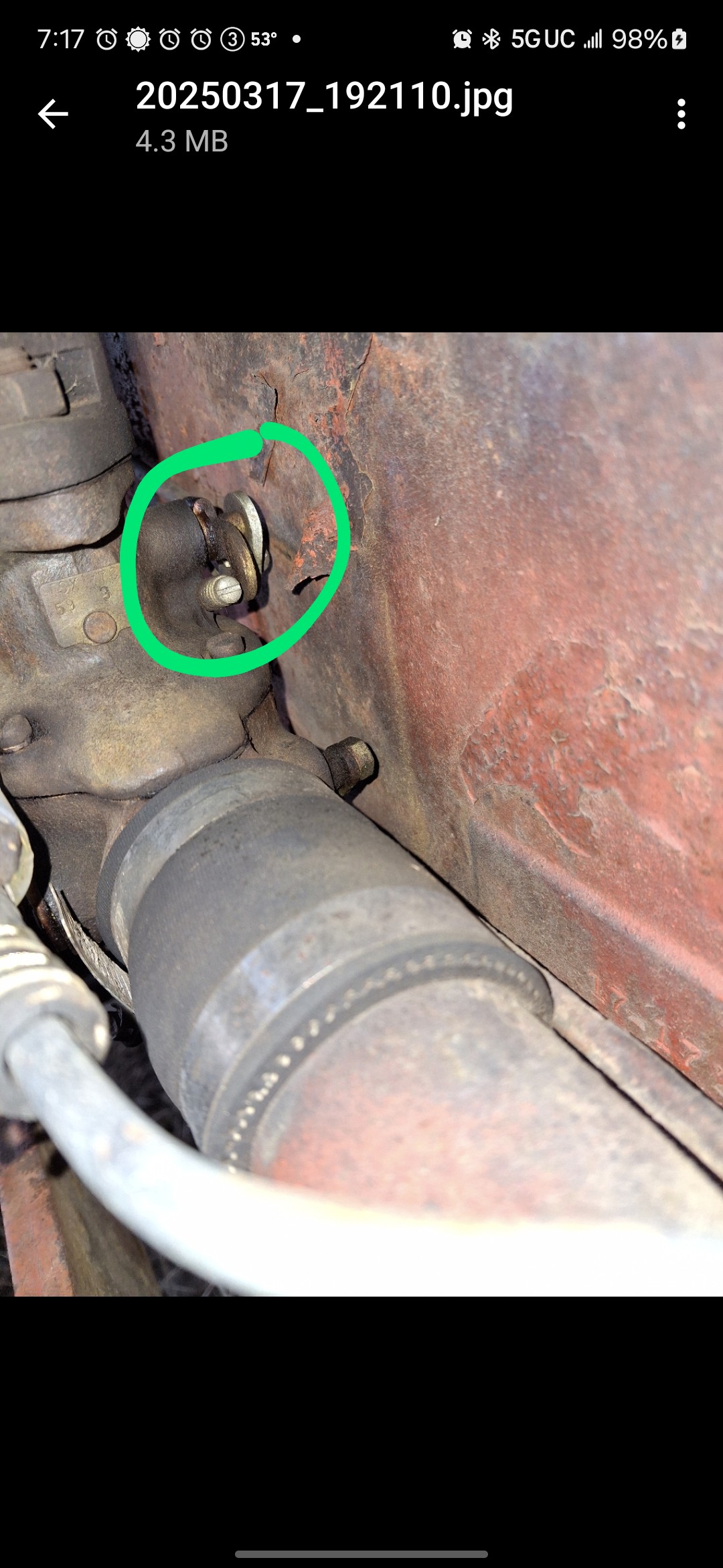

Post Options Post Options   Thanks (0) Thanks(0)   Quote Hunt4Allis Quote  Post ReplyReply Direct Link To This Post Posted: 19 Mar 2025 at 6:18am
So turn this screw in tighter correct?( the screw that I have circled in green is on the back side of the carburetor up against the engine block and it's the only one that I can see that has adjustment) what's crazy is I remember setting all these a couple years ago when I rebuilt the carburetor and added the inline fuel filter in front of the carburetor( do these screws get out of adjustment just by running?)

Points: 93226
Post Options Post Options   Thanks (0) Thanks(0)   Quote steve(ill) Quote  Post ReplyReply Direct Link To This Post Posted: 19 Mar 2025 at 8:09am
yes... that is the screw that pushes on the throttle shaft ( governor rod) arm and holds the throttle plate slightly open so the motor will idle.. Screw it in a turn and then see what happens... adjust as needed.
yes, the second photo looks like the idle screw Mixture... Screw it in till it touches bottom, then screw out 1.5 turns.
