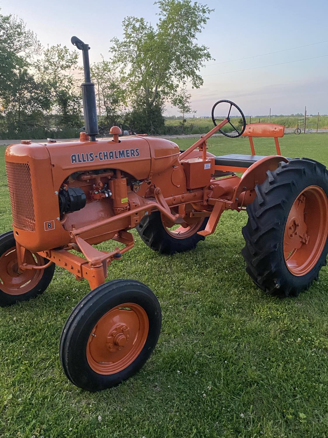

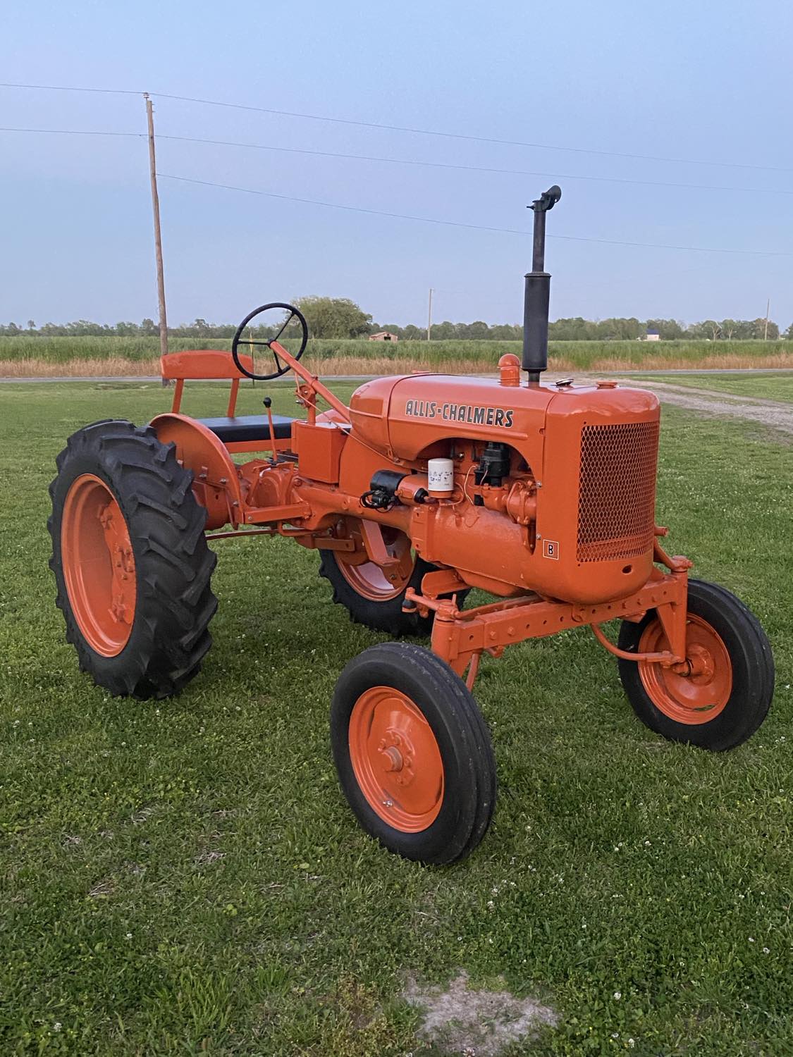

I purchased a restored 1952 AC B high crop Thomson Conversion literally two days ago. The guy that restored it did a really bang-up job on it. I've always been interested in antique tractors and couldn't pass it up. Mainly wanted it to pull a trailer for parades and to pull a single plow. This tractor came with the wishbone bracket but did not come with a draw-bar hitch or any implements. I am thinking that I either want to set it up for a 1940's style plow to pull or for a hand lift plow that has the lever near the operator.

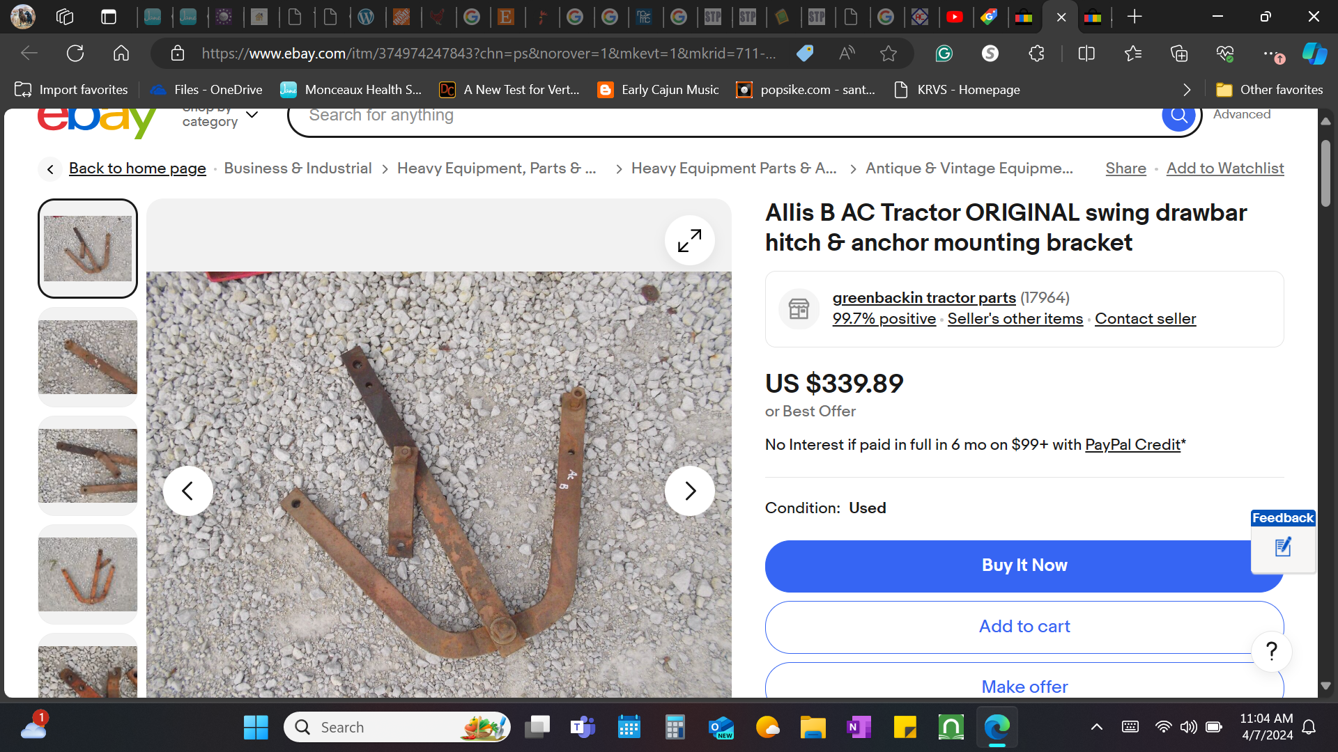

I have come across some original drawbars with mounts on eBay and am surprised how expensive they are. $350-500! These still need sanding and painting. So, I am wondering if there are any people out there who make and sell reproductions of these setup's...? I've checked Steiner and Tony's Tractors but all they have are the 3-point setups.

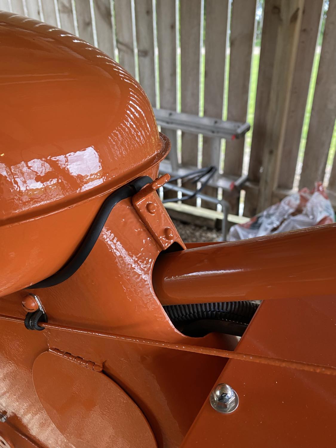

Secondly, I am wondering if any of you know what the purpose of the L-shaped bracket is that is mounted directly behind the fuel tank. I looked at pictures of restorations online and I see that some didn't have this piece, and some did have it, and some had some other variation of it, however, I never see anything mounted to it or it serving any purpose really.

there were a couple variations in the gas tank.. Originally it sat in the saddle and the  wide strap went across the front half and held it on.... later years also had a small strap in the back pointed at the seat, and one bolt that went thru it to that little bracket..
on the drawbar... you have the MAIN U shape unit on the tractor... The e-bay part you show is a swinging addition that you can add to  the MAIN U unit... You really dont need a SWINGING drawbar for pulling the plow for show.. you can sometimes attach the plow directly to the center hole of the MAIN U unit... or get a short extension plate and bolt that on if you need to get the hitch further back..

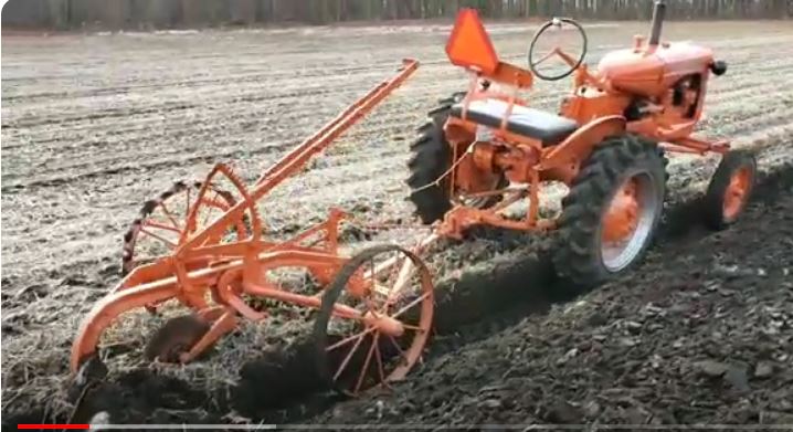

here is a photo of an old wheel plow with rope trip.. You can see it is attached to the swinging drawbar...
