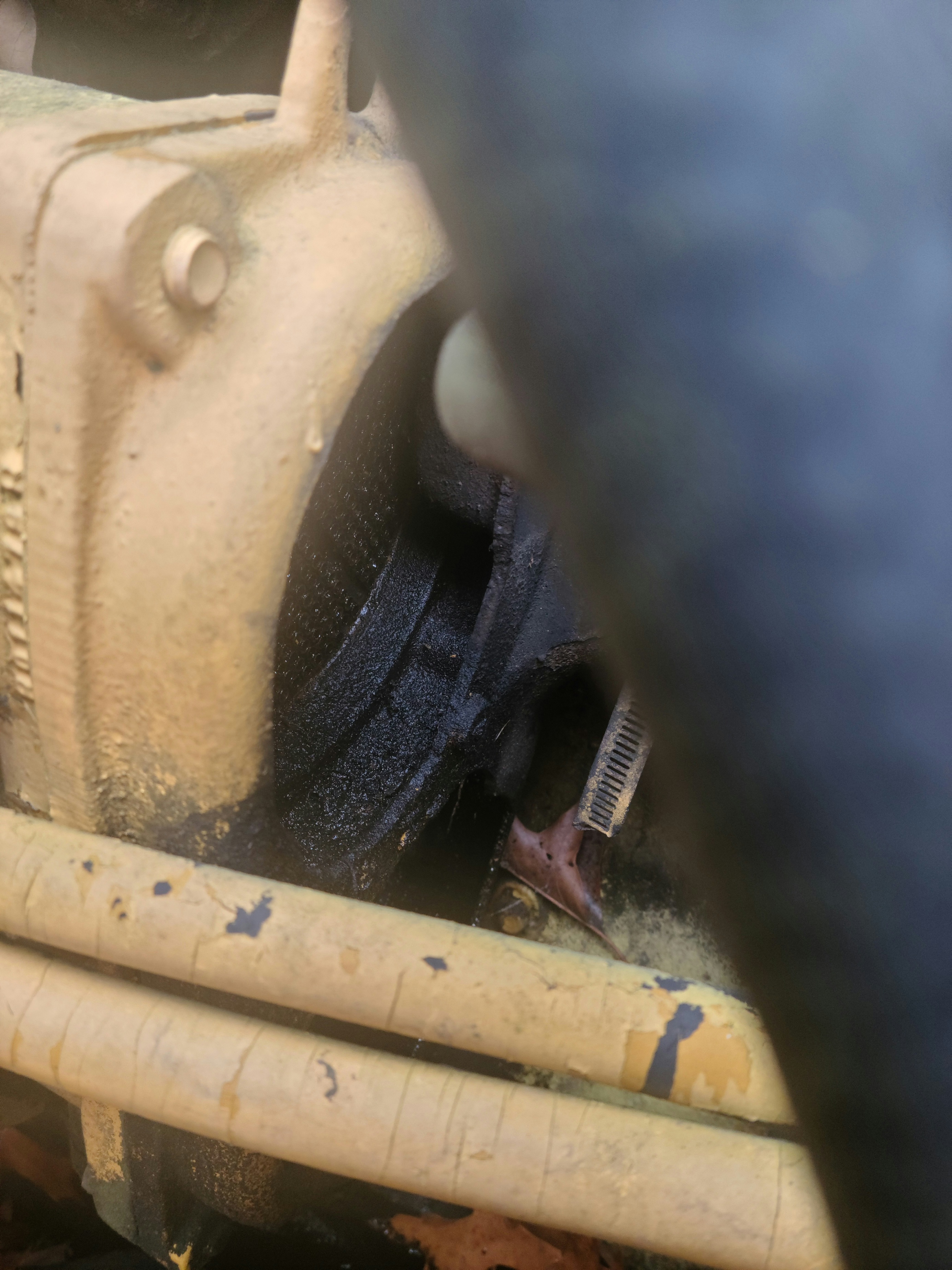

Well i got to see the old girl today. She needs alot of tlc. Does run but as soon as i got it started it blew a line. Its been painted over and has fiat on it but the paints peeling and can see all the old decals. I can probably buy for just above scrap so would have about 4k in it by time i get it hauled home. Only real disturbing thing is someone cut the end of the oil coolers out. Im dumb founded how and why. Oil wasn't even on the dipstick on hydraulics. Engine oil was just black not milky so thats good. Needs injector pump rebuilt cause its leaking some but it started pretty good for being 50 out and not running for a few years.

Post Options Post Options   Thanks (0) Thanks(0)   Quote Codger Quote  Post ReplyReply Direct Link To This Post Posted: 27 Nov 2022 at 7:23pm
From the photo is looks as if the engine coolant was water and froze in the winter months breaking the cast iron cooler housing. This could compromise that oil cooler's integrity as those little tubes that engine oil flows through could be crushed or the solder joints holding them to the end plates could be broken. If the solder joints are broken you would have engine oil in the coolant as soon as the engine is started with the cooler end housing replaced.
This initial entry fee, (purchase price) seems right but the long term $$$ to make it serviceable, and operable can only be decided by the prospective purchaser.
How is the undercarriage and transmission once you have physically seen it?

Mine has "universal" tractor transmission fluid run in it from TSC. When it's changed I'll go to a either a Mobil, or Chevron product meeting the specs, but the TSC oil does also.
Thinking into this; that cooler is for the transmission and not the engine so engine oil would not be into the equation. I do know where there is an 11B parts tractor, but I cannot remember if it was a power, or standard shift tractor as the trans and part of the u/c are gone. The engine is blown in this one.

Are you going to go any further with this tractor? I'll be around the other donor this next week returning a semi tractor I'm working on and will look it over for parts if not a dead issue.
I looked at the front of mine yesterday and it looks set up as the earlier attachment shows.

Two Cooler groups, One housing, One Engine Oil the other Trans oil.  Check at Minnpar before throwing money away, Some pieces are Unobtanium even if listed in their guides, have to do a Quantity Search where NO there are next to no other sources for AC Parts and Rockford no longer services the parts in these.

Dave hit that one square with the two cooler groups, (engine and trans) sharing the serpentine coolant supply path. The rigid fluid lines with the Code 61 flanges are for the transmission where the engine oil has passages in the block for supply and return.
Once you have a good end bell casting it should be easy to cut a gasket. Use the original to gauge thickness of the sheet material to use and invest in a small gasket cutting set. Trying to remember the name of mine but it's been just over 40 years since I purchased it but they are still in business out of Cincinnati, OH. You trace the part onto gasket sheet, set the knives/blades for margin, (width), tape your material down solid, and follow the line you drew on the gasket sheet. Does a nice job with just a bit of practice.  Another alternative is "Olson's", https://www.olsonsgaskets.com/ out of Washington state. They have patterns for just about everything ever made, or can get them.
