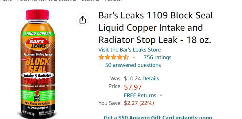

I have used BARS 1109 Block Sealer... AFTER the fact.. On an assembled engine that has a  liner or gasket leak.. Pour into the radiator and let it seal things up... I have never used it during a rebuild..
