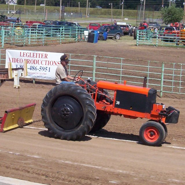

Looking for options an tires to put a a wd for pulling? Tractor will have gleaner motor with wd flat top pistons nothing crazy. What rims would bolt on and work best?

You say WD. Which WD ?? because a straight stick WD has a faster low gear than a curved stick WD.  I'd guessing your compression is higher than 170 psi ?? and you are using the combine sized carburetor ??  If so, if the tune up/ignition timing/governor are all dialed in, that engine should be able to pull in the 3750 thru 4500 lb weight classes in a curved stick chassis with 15.5 x 38 rear uncut tires in LOW GEAR. With a straight stick, it would be more difficult, but maybe possible. Soil types, track conditions, drawbar length and height and the sled itself all have an effect on the results.

It is a straight stick. I was thinking 15.5x38's but not having much luck finding 38 inch rims. Was mostly wondering if there was a mother good option that might be easier to come by

Even if you find 38 inch wheels, they are more likely to be 9 bolt dual wheels, which is lighter weight anyway, and will then have to have 8 bolt centers installed to fit the tractor. Are you competing within a "club" that has tire/wheel rules?? What weight classes are you thinking ??

Well, you need to get the latest rules for that Div 2 class. What I see is a maximum of 170 square inches of rear tire up to 4500 pounds. That makes a 13.6 x 38 your best choice (165 sq inch)and it has to be on a 12 inch wide rim as per the rules. No cut tires. Drawbar at 18 inches high (good for you) and 18 inches short.  10% over on the RPM (good for you) and 3 MPH max speed (good for you). Your speed will be probably 3.5 MPH so you'll have to learn how to drive and run half throttle coming down the track and increase the engine speed the farther you get to keep it at 3 MPH and not get DQ'd. I think your engine will be fine if it is tuned properly and the 18 inch drawbar and smaller width tires also work for your lower HP. The NATPA events I've been at usually had 3500-3750-4000-4250-4500 lbs......every 500 lbs for sure but the ones I've attended were every 250 lbs.

What about 14.9x28 they are listed as 170 sq in would the taller tire be better still or a little shorter tire to slow it down and help with less power

14.9 x 28 is 145 sq inches and meets the 170 sq max inch rule. They will be slower. They will take less HP. They will not finish well. 38 inch outpulls 28 inch.

 Pulling is a game of may variables, what works for someone else with lots of HP may not work for you with a stock engine. Tall tires are not always the best if you don't have the power to turn them. You may need to try many different sizes before you find the best match for what you have. Any tire you try you do want to be a s close the the 170 sq/in as possible. How many sq/In is a 16.9X28? That will gain you a little height and width over a 14.X28. As mentioned above the 13.6X38 tire , you'll have to run at part throttle until slippage increases and if you are too late trying to get the engine speed back up it may not come back.
  Look on the chart and find all the tire that you'd be allowed to run for your lightest class and pick a rim diameter that is midway between the 28" and 38" . Might even try finding a 36" rim, That will allow a little more engine speed at the beginning of your pull and might match your stock engine better. There are times when using a tall tire you want to be narrower that the maximum allowable tire if you don't have the power for that ground speed.
  Be open minded to make changes after you get started. Finding the perfect combination won't happen right at the start. Also be aware that most everyone else that has been pulling for awhile has already worked trough what your are just getting into. Even if you have the same tractor as someone else, there are going to be some differences that need to be allowed for, most of which the other guys won't tell you about.

  Taller tires are always better, a longer footprint is better then a wider one.  I have NEVER seen a JD, IH , Oliver put on a shorter tire, that would be a joke to them.

What this: 18.4X16.1 tires on a CA in 3rd gear. The only thing that can out pull it at 2500 pound is our other tractor with a turbo.
  For many years I pulled a CA with 24" tires and consistently beat the two 66 Olivers and a Farmall C that squeezed into the class after the class weight was increased 100 pounds. Then after they got beat hands down for a couple years they initiated a speed limit that was too slow for the CA in 2nd gear. Now they just have a 2750 class.
   It's all about getting a perfect combination that works for any give tractor. For all the variables there are NO absolutes.
  The reason the Oliver, JD  & Farmall guys don't run 28" tires, those tractors were not designed for them and have lower gear ratio transmissions in their granpa gears.
 The Allis tractors are designed for 28" tires and putting a 38" tire on them is the same as running 2nd gear. Fine if you have the power to do that. Many don't have the power to do that when they first get into pulling and when they do the wrong thins and place at the rear of the class all the time they will quickly loos interest and swear the winners are cheating.

A true story: An old friend of mine (and a very distant relative too) had a very good WC antique puller in the 3 MPH class. Year after year he was the points champ in the local club (about 6 events per summer) with 38 inch cut rubber. There were several very unhappy Deere pullers that tried every year at the rules meeting to have his big diameter tires banned because a WC didn't ever come with 38's. They did however come with 36's as an option. So, seeing the handwriting on the wall, he built a second identical WC, only with 28 inch cut Armstrong tires and I think they were 16.9 x 28's. At the end of the summer his 38 inch tractor was still the points champion. Second place in the points was his 28 inch tractor, still ahead of all the other competitors!!!  This somewhat proves two things: He KNEW what he was doing with either tractor better than his opponents. He also proved that in general, the 38's would still most of the time outperform the 28's if they were of pretty equal sq inch foot print.
