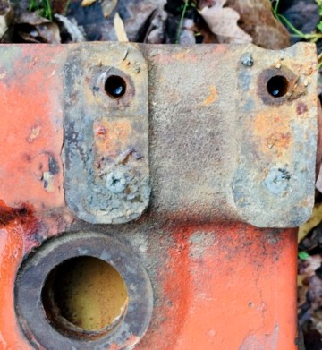

Make sure the mounting  holes are same on block where frame to engine mounts bolt to block , different hole spacing will need those blocks to frame .,and the the fuel filter housing bolts on block .Over the years I have changed just blocks n complete engines n run into this .
