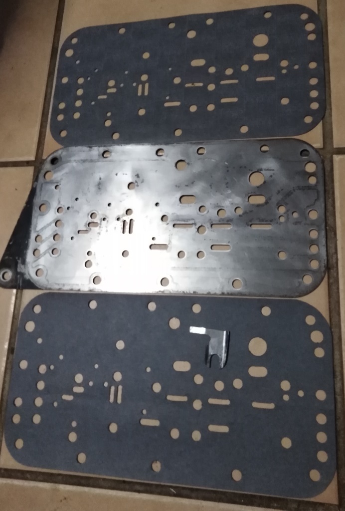

So this is what made my Allis's clutch not work. It broke some how and made the clutch inching spool not travel where it should for the clutch to disingage.
Can anyone tell me what the function of this stainless steel sheet metal fork is, why it ended up broken and how I could prevent it from happening again?
Thanks guys

They do that over time. I suppose the more the clutch pedal is used, the sooner it does it, like maybe a tractor that runs a round baler. You are not the first. It probably won't happen again for another 35 yrs.

its going to be tricky for me to get that part in/to South Africa, so would it be possible maybe to make it myself? i would definitely need precise dimensions if i would try it?

Well, you'll surely need the 2 valve body gaskets and the inching spool seal and the shift lever shaft seal. What are you going to do about those ??

the gaskets ill have to make myself, using high pressure paper.
the 2 seals was still good beforehand and i will have to hope it'll stay that way for now.
i managed to get the dimensions i need. doc, what i do need to know is whether this fork fits snug into the valve housing groove, because it seems that way? (the 2 bents on the sides seems to make it fit snug?)

It just drops in the slot. The little handle sees that it is positioned correctly. I've been known to do things the hard way, but I cannot imagine making those two gaskets. Can't I simply UPS or mail you these parts ?? They would easily fit in a manila envelope.
