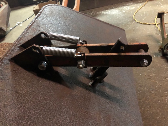

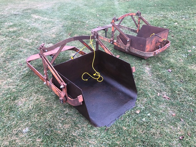

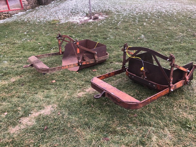

The dirt scoop was reversible yes, pull the side pins and reverse the direction.
I have also attached a picture of what the spring mech should look like, I have rebuilt a couple of these scoops now and highly recommend replacing the springs.uploads/9251/003_.jpguploads/9251/001__2020-06-08_14-27-12.jpguploads/9251/069_.jpg

That makes it pretty clear. Especially the picture of the latching mechanism. Where do you tie the rope off to keep it handy but out of the way?
