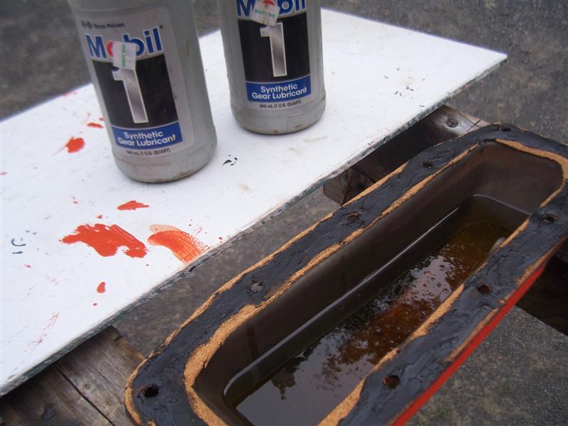

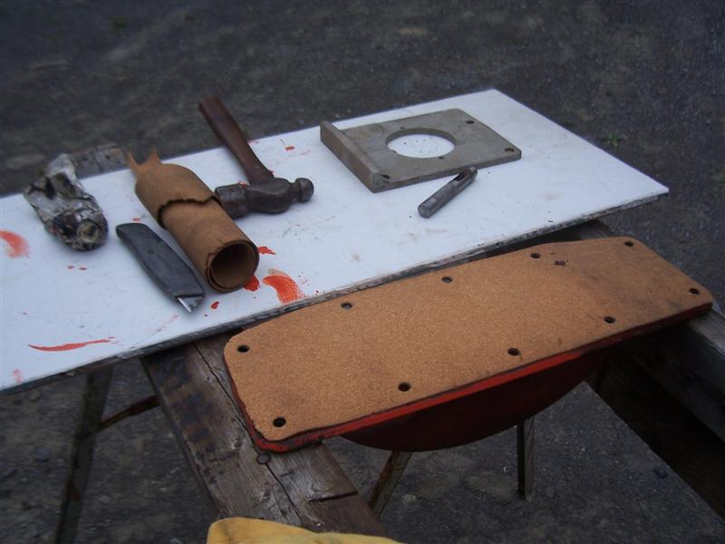

Remove pan to drain and wash it out clean. Get your new gasket glued solid to the pan, dump in 1 quart of oil, install back on the tractor without spilling. Wheels out make it easier to do.

I did this on my D 15 just like Dr Allis said . Well I did pull the wheels off . Don't think oil should rush out when you remove the side plug . Sounds overfull to me . HTH
Post Options Post Options   Thanks (0) Thanks(0)   Quote CTuckerNWIL Quote  Post ReplyReply Direct Link To This Post Posted: 04 Mar 2020 at 2:02pm
The plug in the side is the fill hole and fluid level should be to the bottom edge of the hole.

Post Options Post Options   Thanks (0) Thanks(0)   Quote Brian G.  NY Quote  Post ReplyReply Direct Link To This Post Posted: 04 Mar 2020 at 4:28pm
The Doctor is right, wheels out makes it easier.
I've done this on a few of my A-Cs, the latest being the D-17.
You may find some crud in the bottom of the pans........rarely did
anyone ever change the fluid, let alone every year as A-C recommends.
You can buy new gaskets, use silicone or make your own like I did.
Not a big job but it would be a lot easier had A-C put plugs in the bottom of the pans.
The good thing, I guess, you get to see the condition of the gears.
There have been those who went to the trouble of installing plugs.
