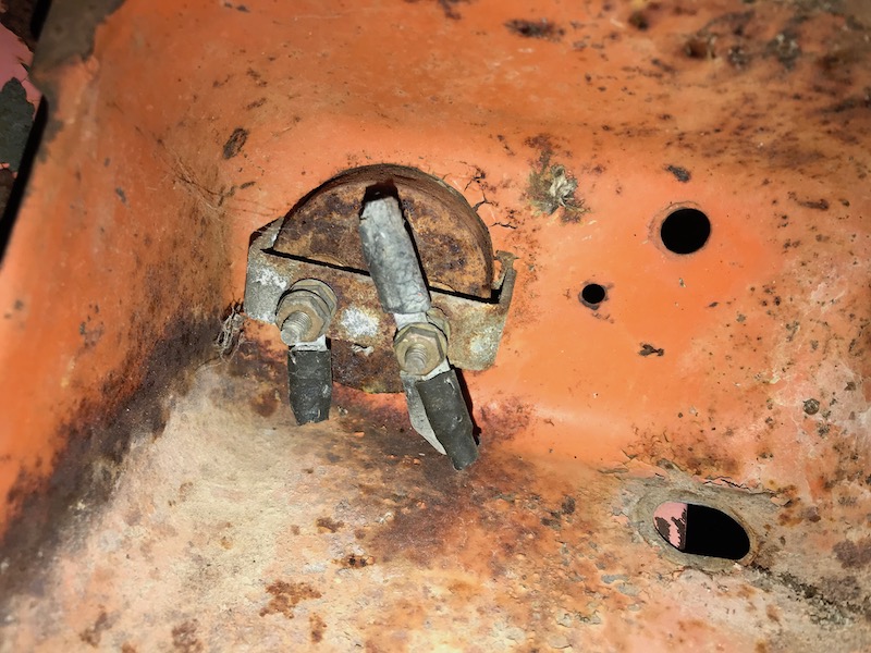

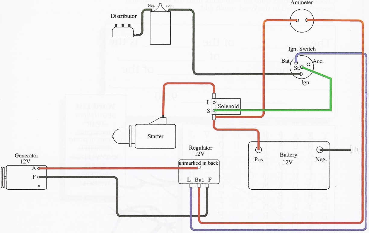

Hey fellas. I'm starting to understand the wiring on this 1955 WD45. Have found a number of wiring diagrams for it. However, I can't understand why this old ammeter would have two or three wires on one post, and one wire on the other. I do have a new one ready to install, just trying to understand the wiring for this so that I can do it correctly. I also just want to make sure this is the correct diagram to go off of. Thanks for your help!

you can get power at the amp meter terminal to run accessories...might have a head lite wire on it...... the drawing is FINE if you use it.
Edited by steve(ill) - 19 Jan 2020 at 5:09pm
Points: 93197
Post Options Post Options   Thanks (0) Thanks(0)   Quote steve(ill) Quote  Post ReplyReply Direct Link To This Post Posted: 19 Jan 2020 at 5:06pm
also your regulator shows 4 wires... some don't have the blue wire to the ignition switch... you might get power to the switch from the common terminal on the amp meter.

I think you may need a different drawing. I have  a wd, not a 45 but it is six volt positive ground and no solenoid for the starter.

The diagram you're showing is a 12V Negative ground system. If you are going to stay with the 6V PG system, than you need the correct diagram. The original 6V PG system did not incorporate a Voltage Regulator, although a VR would be a nice upgrade for the 6V system. The OEM 6V system used a Reverse Current Relay or better known to the industry as a "cutout". Its only purpose in the system was to sever the Battery from the Gennie, so the Generator wouldn't act as a Dynamo and drain the Battery while the Tractor sits not being used. The OEM system used a multi-function Headight/Charging switch in the dash to increase or decrease the ground at the Gennie for charging.
An Ammeter is a flow meter which means you need to send full current through it in order for it to tell you something. The Ammeter is wired where the Battery is on the + side of the gauge and everything else (accessories) is off the - side of the gauge.  On the OEM system, the Headlight charging switch borrowed current from the - side of the Ammeter along with current for the Ignition switch to power up the ignition circuit if Distributor equipped.  I offer a complete 6V system for the WD/WD45 if interested. If you are deciding to go with a 12V system, I offer a kit for that to...    HTH

Your picture is the perfect example as to WHY you need to replace the fibre insulating 'washers' on the Ammeter posts !
You can clearly see rust around them,so moistures is /was there. This moisture eventually attacks the fibre washers and a small amount of current can flow from the battery to ground. Once current flows, it gets worse..It may take days or weeks, but ,hmm... battery's dead, arrgh.
When I replaced mine I used Nylon ( plastic) shouldered spacers AND an extra Nylon washer. I also lightly scratched up and painted the new  clamp
A small amount of never sieze or electrical grease  should be used too.
Ammeters have been given a bad rap, yet IF properly installed and maintained, they'll do their job for decades.

Dave's  right, you'll need to swap the ammeter wires. Just looking at the picture again, and it's kinda obvious nobody has touched it since it left the factory.
You may want to buy a new one first though. Less than 50/50 odds you can sucessfully remove the nuts AND keep the insulating washers in one piece ! Before you try, use a fine wire brush to clean up the studs and nuts. You might get lucky, maybe.....

Thank you all for your replies. I’ll be sure to get those posts switched around. The one in the pic is the original 20-0-20 and I actually didn’t have any difficulty taking it out. The ammeter I have in there now is brand new from the farm store. It’s a 30-0-30 and works well until it jumps backwards at charge, lol. I’ll update here soon as I have the job done!
