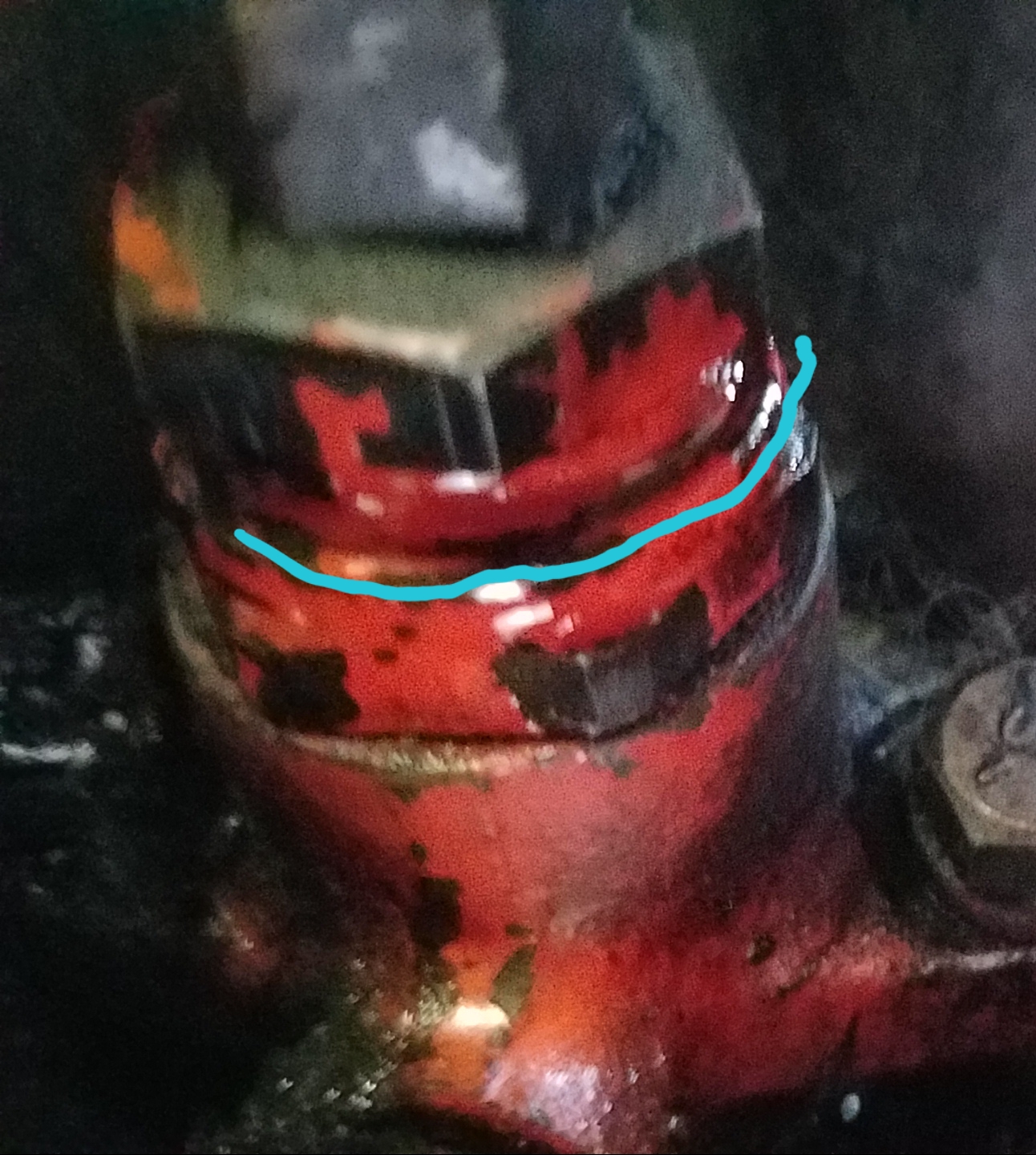

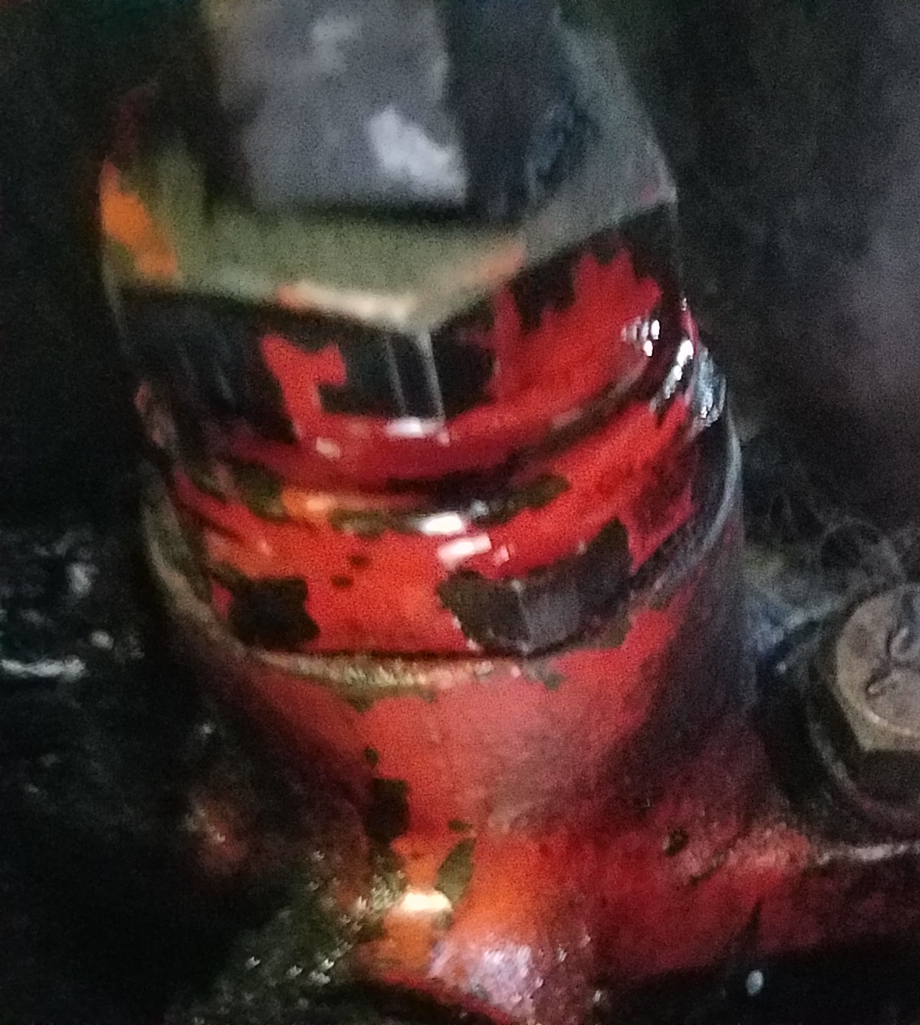

How do I fix this leak? it is not the return line.

From picture, I can tell nothing. If it is leaking between adjusting nuts, there is a oring inside. If it is leaking at nut on drip tube, there is a rubber bushing in nut. If it is leaking where injector goes into head, replace the valve cover gasket.   MACK

LOL! Yeah,my bet is the cover gasket.Wink

it is leaking at the blue line. It is diesel fuel.

Inj has to come apart to replace the oring inside. That isn't an original 210 injector. It will need reset once the adjusting nut it removed, and oring is replaced.

Thanks Ed, I pulled the injector and took it to the neighbor who has a injector tester. He took it apart replaced the oring and set it at 3100 psi. I put it back in and no leaks. He seems to think those injectors are out of a 7000 series tractor. Why would someone have changed them from the originals? Any thoughts of why they would have changed them out?

Being there not original I would pull the other five cuz you have no idea what they're set to now you got one correct and 5 maybe something else
