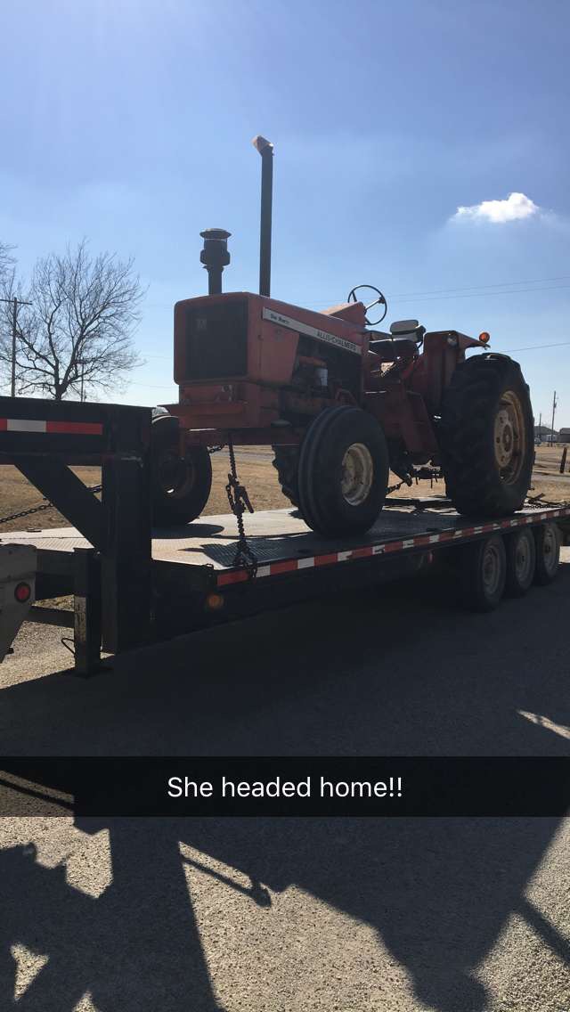

Wanted to get a picture of my tractor when we brought it home last weekend
190XT, 185, D15 SII, 7040 is living again, 7010 retired for parts.

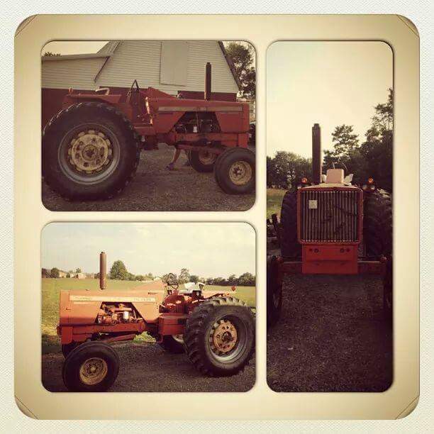

I sold fuel to many farmers with 190's back when they were the "big tractor". My dads early 190xt was the only 1 I remember with 34" rubber. All the rest were 18.4x38's. I would not hesitate to do what you are wanting to do. I sold several step up kits for Case when I first started in the tire business in 1986. I do not remember anyone being unhappy with their decision. Have fun - just remember to recheck all bolts.
ezlle71 View Drop Down
Joined: 22 Jan 2018
Location: Kansas
Points: 62
Post Options Post Options   Thanks (0) Thanks(0)   Quote ezlle71 Quote  Post ReplyReply Direct Link To This Post Posted: 09 Mar 2018 at 11:58pm

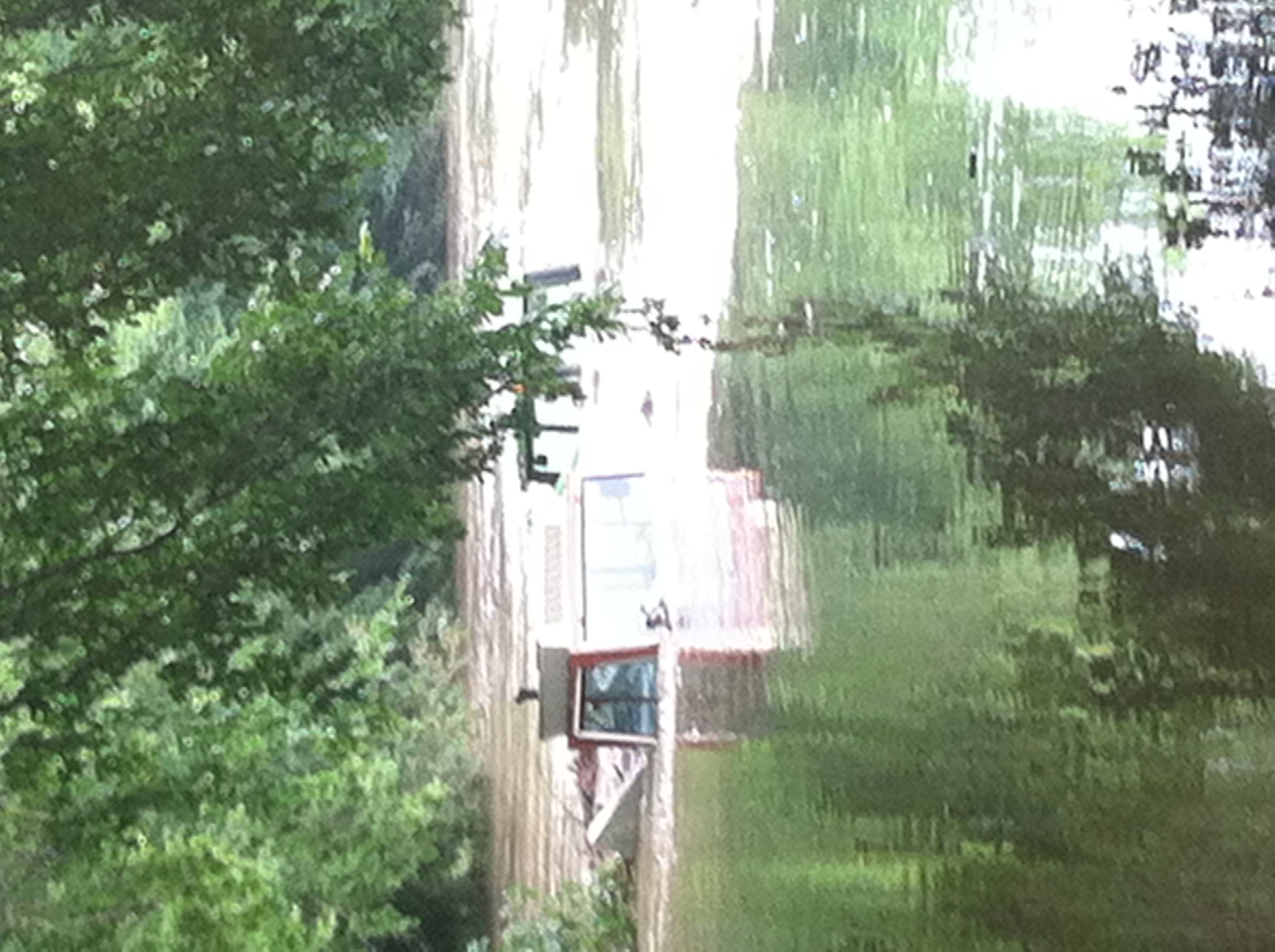

It’s hard to believe that’s the same tractor. That’s my dads 6400 next to it. It stalled on my dad and him and my mom went down there with my XT to pull it out but the water was rising to fast. Thank god they both made it out alive.
Allis dave View Drop Down
Joined: 10 May 2012
Location: Northern IN
Points: 3182
Post Options Post Options   Thanks (0) Thanks(0)   Quote Allis dave Quote  Post ReplyReply Direct Link To This Post Posted: 12 Mar 2018 at 7:23am
wait... So what happened here? How they get flooded out? Sounds like a scary story
Joined: 22 Jan 2018
Location: Kansas
Points: 62
Post Options Post Options   Thanks (0) Thanks(0)   Quote ezlle71 Quote  Post ReplyReply Direct Link To This Post Posted: 12 Mar 2018 at 9:41am
That will be 5 years ago in August. The 6400 went down the road as salvage. We bought our 7230 and we cleaned up and repaired my 190xt. The water went over the top of the roofs of both.
Joined: 22 Jan 2018
Location: Kansas
Points: 62
Post Options Post Options   Thanks (0) Thanks(0)   Quote ezlle71 Quote  Post ReplyReply Direct Link To This Post Posted: 12 Mar 2018 at 12:58pm
Dad had went across the creek to take salt and mineral to the cows. He came back and the water was about 4 ft deep in the crossing. A big wake went out in front of him and it came back at killed the engine on the 6400. He swam out and went up and got my mom and my tractor. Tried to pull the 6400 out but the water was rising to fast. He bailed out of the 6400 when the water went over the top of steering wheel. Swam to shore and got my mom to the bank. Not bad for being 65 at the time lol
