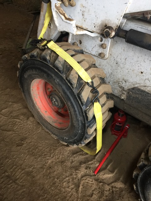

My Bobcat decided that it was time to test my patience. Had to get a round bale for our horses and came to a flat tire. Plugged it 2x before it would take as it is a tubeless tire. Then strapped it to get it hold air as the bead had broken.
After a couple of hours,,,, success.

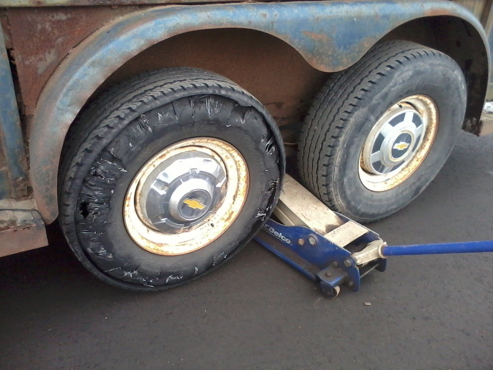

Tires, you never know... Hauled a load of moo-moos yesterday 50+ miles and had this happen a mile from destination.  Just kept going and unloaded and then went another mile to a tire shop. Didn't have a spare with me for the trailer, other than a different size wheel for the truck.
They were real busy so i asked if they would loan me a jack and a wrench. Dang nuts were really on tight but got them cracked loose and jacked up. and then rolled the wheel in and a bare rim and got  couple good tires put on. paid them and got back on the road and hit the wet slippery crap snow going home...
 Funnier part was, I checked the tire pressure of all four wheels in the morning and this tire was always at 70# pressure and did not see any cracks in the casing either, and thought to myself that it was the best tire on the trailer. LOL
