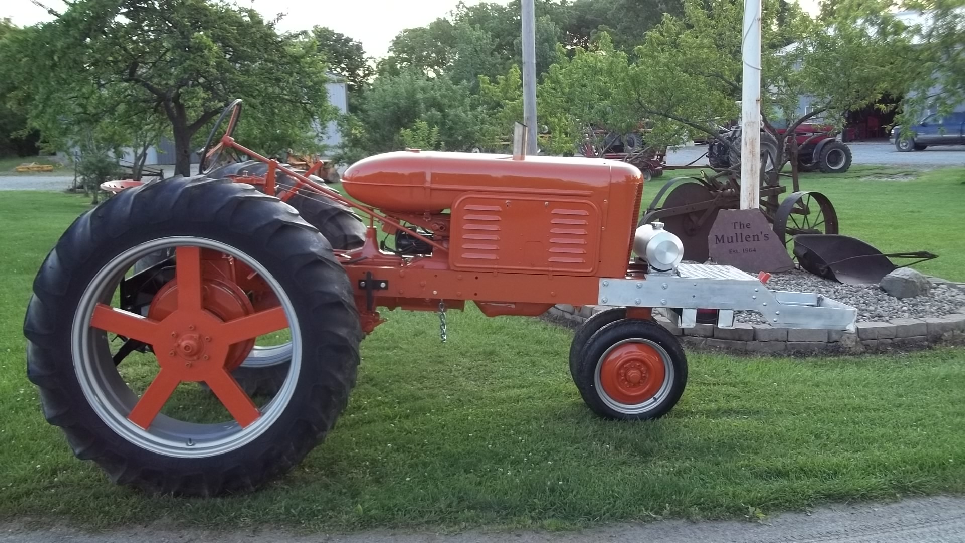

I made my own

Post Options Post Options   Thanks (0) Thanks(0)   Quote allischalmerguy Quote  Post ReplyReply Direct Link To This Post Posted: 27 Jun 2016 at 9:56am
Originally posted by patrickmull patrickmull wrote:
I made my own
Patrick. Nice job. Those look great! I would of liked to watch you do that.
