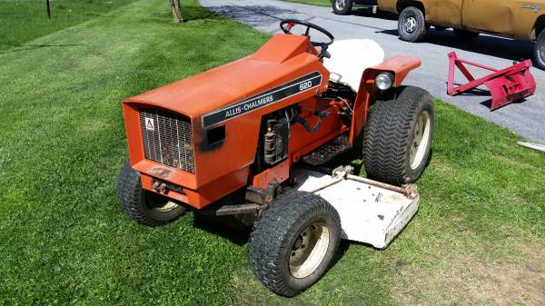

here is a pick of it...

Can the 620/720 60" cut taller grass quickly like you see them new high powered zero turns? I say no. Just last week I was cutting juicy green grass (with my 620) about front tire high. The deck can't eject the clippings. I do have the "rock" guard installed. I creep thru that tall grass, and can hear the clippings making a flapper like all wadded up noise, then they finally get spit out , looks like a cow puked. Sort of pathetic actually. The deck also isn't good at sucking up leaves and chopping them. Leaves in a hole or wetted down are untouched. On shorter grass, yeah you can go 60" wide at a good clip. I think your 2 hour time would go down vs. the machine you are using. However, I have a JD 318 with a 46" deck and essentially the same 2 cyl Onan motor as the 620/720/Powermax. It can chop through tall grass and suck up leaves. My 620 can't do like that, even if I take a narrower cut.
On the other hand, the cut looks really good, all them rollers prevent scalping. When I got done cutting, I thought, wow, the place looks like Augusta golf course. Not looking in the direction of the miserable-cutting tall grass.
Disclaimer, I bought this 620 used about 2.5 years ago, it seems to be a typical working example, but maybe something is wrong. I have no experience with them when new back in the day. I was considering taking off the rock guard.
IF the machine had a 540 rpm PTO I would set-up my little 620 garden tractor as a tractor, not a large lawn mower. Use a 3pt finish mower, 12" plow, 4ft disk, drawbar 6ft rotary hoe and drag harrow. No mid mower deck swap.
Something tractor-like and sort of in the same league- Simplicity Conquest XL, John Deere x700 series, or their prior 585,485 , maybe 425.
You can get 4wd, water cooling and 540 rpm PTO and mini-cat 1 hitch. Nice are the lawn mower like foot pedals for the hydrostat. Kubota BX's are option also. These machines I just listed cost a mint new, could be $14K. But didn't the 1975 620 cost about $7500 when new?
Good luck finding any of the above alternatives for $1500.

$1500.00- I think that if the  tractor works properly, I would grab it.  Paid much more than that for mine - a 1974. I have mowed grass that is not dry, but not as high as the front wheels, tho - just normal height to be mowed.  Works well for me.  Usually mow in 2nd gear, and over half way on the hydro lever.  We don't have real good grass around here, but it seems I mow at a faster speed than my neighbor does with a comparable size unit, (much newer,but smaller mower deck), plus the AC leaves a very smooth cut.  I do not have a rock guard on my deck.  My other mower (year 2000) also has a 20 hp. engine, but a 48" cut.  Makes a lot of difference cutting 12" inches more each pass with the AC.
It seems that quite a few commercial landscaper/mowers in our area use the zero turns - have seen them cutting in light rain, and doing a decent job - again, just on grass that needed cutting, not wheel high grass.  Seems like they are very fast, and of course quick turning.

Nice looking machine.  If it starts, runs, steers, moves properly and everything functions properly, $1500 is a good buy.  Good luck finding a solid 620-720 with a good functioning deck for any money.  And as stated above, $1500 will not buy anything newer that can do what a good, functioning 620 will.  I have a nice 720, paid twice what you're looking at but did get a rear Woods mower and a tiller.  The Woods discharges out both sides so it handles taller grass quite well.  I made quite the trip to get it.......but if you want it, you gotta do what you gotta do.  Glad I did, love mine.  Good luck.

A 620 does a good job cutting grass, but don't expect to be finished with your lawn in half the time.  While they were made to do a good job, they were not made to do a good job QUICKLY!  Also the turning radius on them are probably worse than your current mower.
Much as I love my 620, for your purposes a newer zero turn would probably work best.

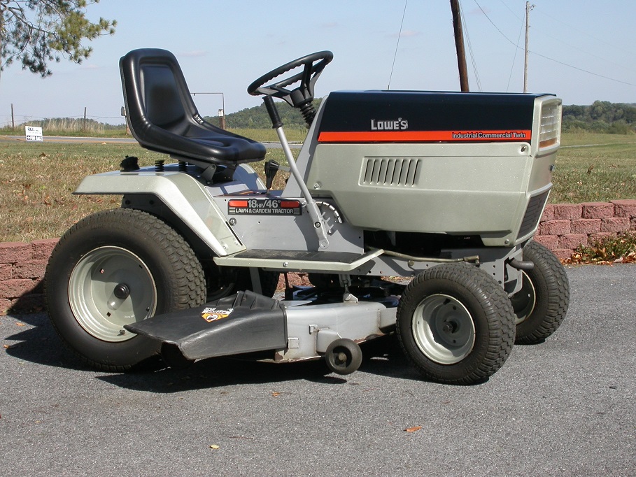

My deck is set up correctly including difference in height from front to rear and my blades are always sharp but I have never tried a "High Lift" blade so as to cut all the grass nicer at a slightly higher speed. If I could do that I would just keep my reliable MTD...actually it is a LOWES. I'm sure you guys know the story of this particular model MTD.

Its taking you too long to mow your lawn with the MTD. I could mow about an acre in about an hour with my Simplicity Landlord with 50" deck or JD345 with 54" deck. I don't mow when its wet. It makes a big difference cutting dry grass. If you mow wet grass and don't clean the deck out all the time you can expect the deck to rust through.

I decided to try a modern set of blades for my Lowes/MTD. Mine does have the more desireable deck that doesent scalp with all of its wheels and is true floating but for $70 its worth a try.
   The AC runs well, turns, changes direction and cuts grass as well as I guess it should but deck control does not go up properly, the guy seems to think the bleed or down valve may be hanging open. He says the same hydro pump drives the trans and the deck piston under the seat so obviously the pump is ok. Also if it were mine I'd disassemble the thing completely, sandblast each piece and re assemble the thing so it would look sa good as my MTD. As of now I don't need another project.
       Possibly for a few more bucks and a little luck I can get something that I wont have the never ending desire to completely disassemble and clean up. All my junk is older as I keep stuff forever but it is all clean under a small layer of dirt like my MTD.
   If he still has it after I try a newer design blade on my existing machine and still am not happy I may check it out again if he still has it. He is a friend of mine so I don't think its right to ask him to hold it for me as I may not buy it so I am going to add this link to the craigs list listing he has it under. It is in Adamstown which is in  Frederick County Maryland.
