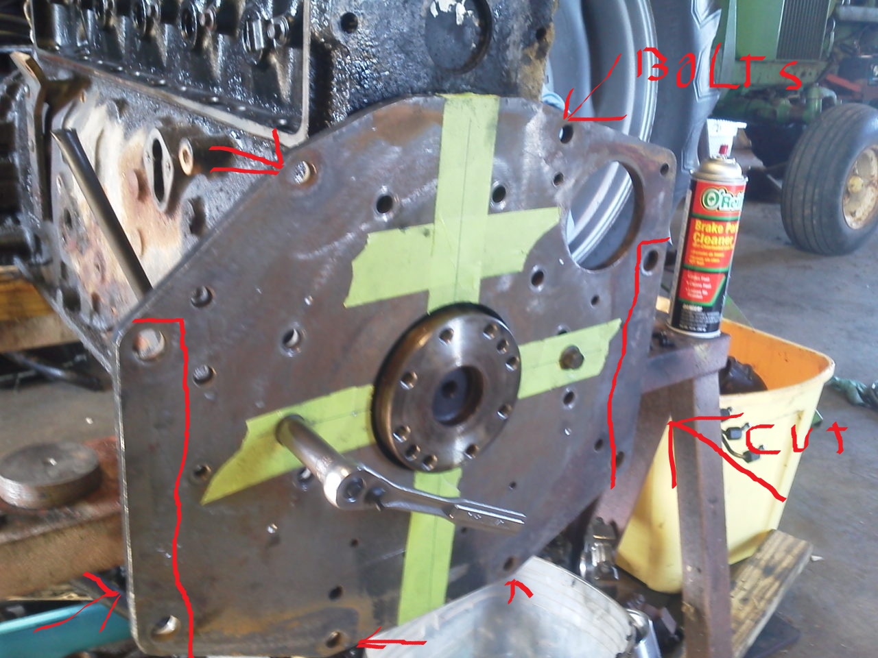

Will I hurt the strength of the tractor if i cut my adapter plate so I can remove engine without completely splitting the frame and unhooking all the wires and hoses to get to clutch? Will the 4, 1/2 inch bolts be strong enough to keep block in its place?

A D-21 rear adapter plate does not have the frame bolts pass through it. There would be a dowel pin and the 1/2 inch bolts on your 7000 that would be left to hold the engine i would think that would be fine, unless i am misunderstanding the pic you posted.

I'd do it.
I've seen a lot of supers that generate aver 2x the torque of tat cummins that are held in with much less.

Yes thats all holding the back of the block but still has front mounts.

I think the 4 half inch bolts will hold it fine, since the plate won't be the only thing keeping the tractor in one piece, the frame rails will be there still. Looks like a nice idea, but I wondered if you'd have enough room to go straight forward to clear the input shaft upon engine removal. I guess at 6500# you've likely made your own front support, and went with a manual rack & pinion setup? Keep pics coming Bob! See ya in a couple weeks!

What kind of clutch you running??  Just curious.....hard to beat a crower, once you get the hang of it, cut the bellhousing bottom out too, that'll help alot if you haven't already.  And my piddly opinion the plate will be fine doing what you're wanting to do.

Bob , I have done this sorta thing in the past on mod set up but I installed a torque arm to the frame to keep torque twist limited . I felt this way not so much stress on the structure. You have a good idea rolling . Like ur tractor !

Good idea Wild Bill that distributes the tourque evenly

I used a dog bone from a Pontiac Car i had laying around . The bushing in the arm gave it little cushion and was easy to take off with pins then the 4 engine to bell housing bolts . Never had issues . Take care happy new year!
