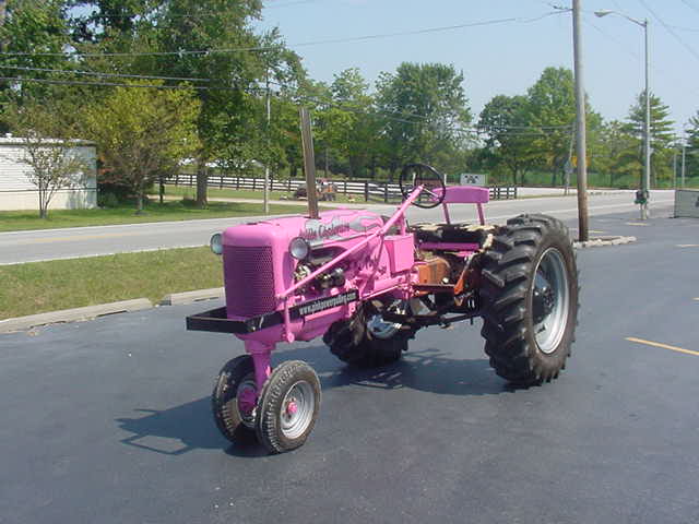

I have been building a CA puller and have got it down to 2350 naked, has anybody got their's any lighter or have any ideas of how to improve it?

Anybody else wunna show off their CA pullers?

I would love to, but I can't do pictures. But , at Lynden, WA my wife hooked 5 times and got 5 blues with the CA. They started to call her 'ol Full pull cause every time she hooked she took it out the end @ 260 ft. It is'nt fast with a stock motor but it just won't quit pullin. I pulled it @ 3k and won the class BUT, not a FP like she does.

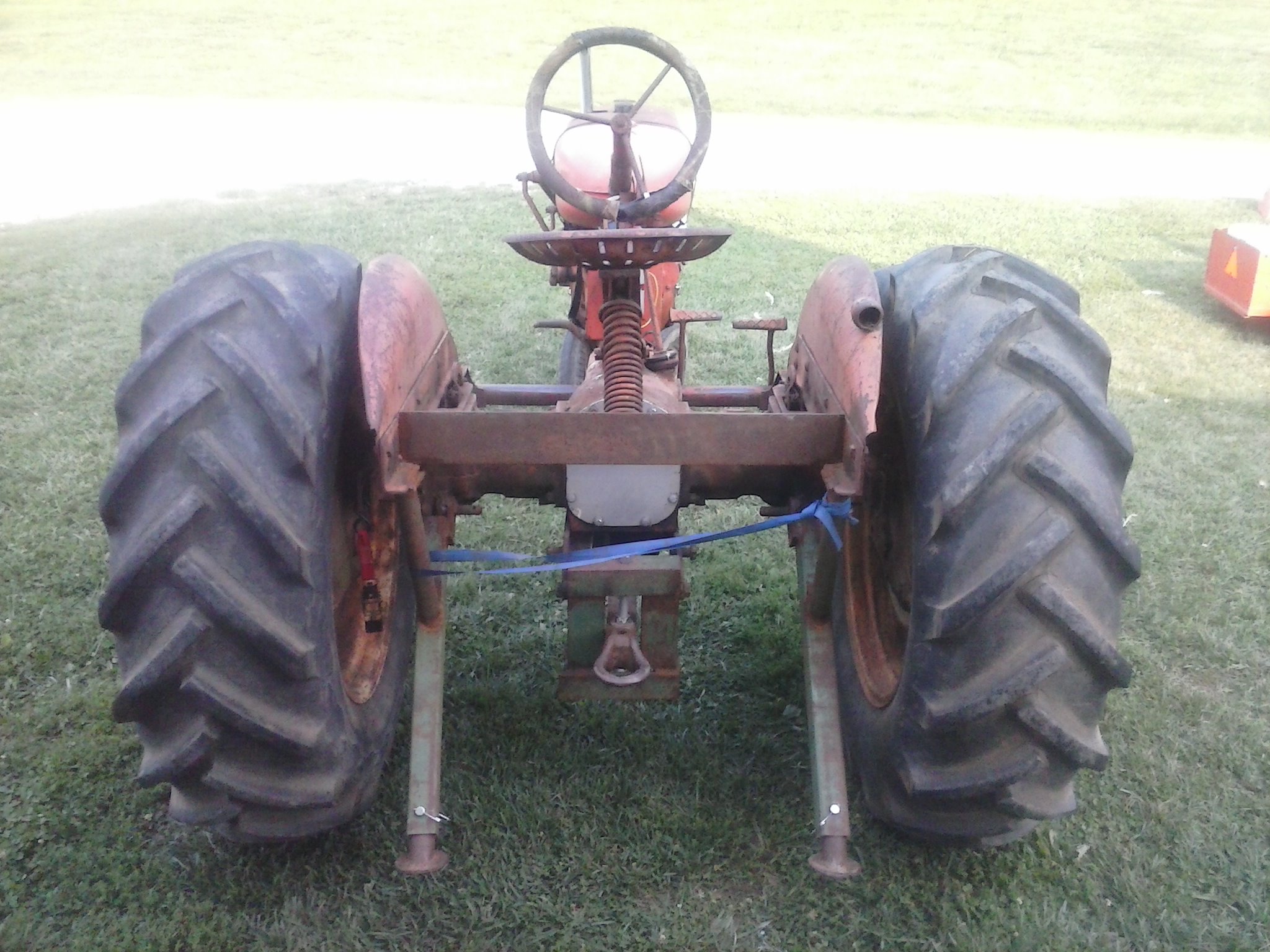

Mine is 2300 as is with most of the stock stuff still on it.
take the fenders off
Take the seat assembly off and use a cheap light seat
Take the brake pedals and hardware off and use B hand brake levers
How is the front pedestal holding up with the front weights hanging off of it like that?

I've also seen:
Take the throttle quadrant, and steering support off.
Remove the steering shaft cover and shorten shaft and use a PVC cover
Remove the tank support and use lighter material
Move the battery up front.

If your really serious you can get a CA to weigh 2000 pounds with a 125 pound driver. Small lightweight front tires, magneto, no battery, no starter, PTO delete cover, Pressed steel rear rims and tubeless tires. All this can be done with no aluminum whatsoever. When I did this more than 20 years ago I i only had a stock engine and I could easily run third gear with 12.4X24 rear tires. I smoked cubs ponys and Gs so bad that most everywhere I went they were such poor losers that I was generally always asked not to bring that CA back

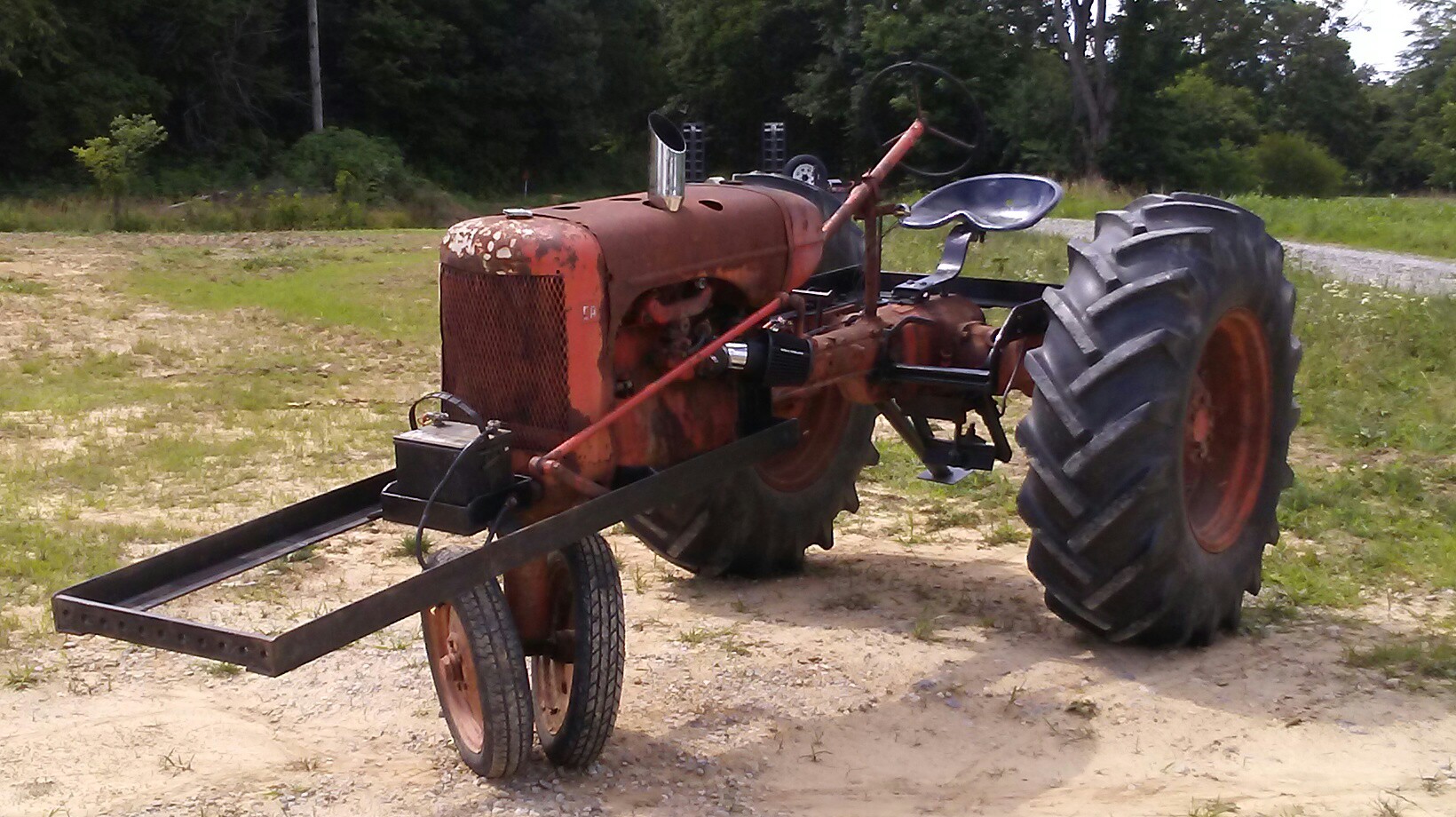

Post Options Post Options   Thanks (0) Thanks(0)   Quote 1955allisca Quote  Post ReplyReply Direct Link To This Post Posted: 29 Jun 2017 at 7:20pm

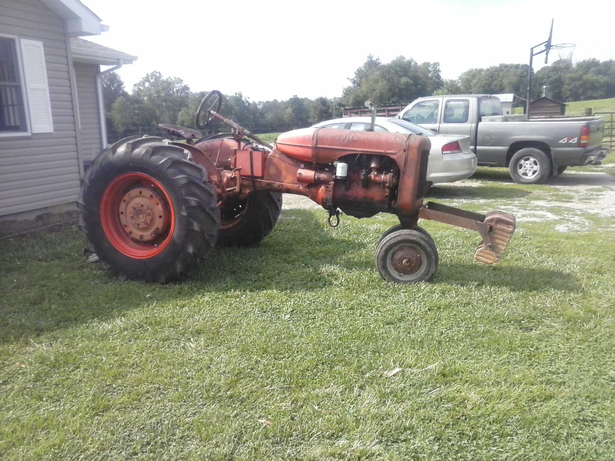

let me see what I need to dump to get below #2500.with my #175 in the seat.  All my cast iron weights (2 engine side weights & 2 Farmall Wheel Weights.and all the liquid ballast (water) in my 13-6 24  Firestones.  On paper I am now at  2400 pounds with me in the seat.
    I can hang my 5 100 pound suitcases and pull #3000 easy enough.

Well I got my CA down to 2500 with me driving. Where should I hang 500 lbs of weights? AHEAD of but close to the centerline of the rear axle or BEHIND the Centerline of the rear axle to pull good  in 3000. I'm leaning to slightly ahead
    Seems like if I hang 500 pounds of weight behind the  rear axle I will be  way light up front.   All out of Balance Front to Rear.
     I really enjoyed pulling this CA in #3500 and #4000.  Plenty power stock.
Points: 5459
Post Options Post Options   Thanks (0) Thanks(0)   Quote PaulB Quote  Post ReplyReply Direct Link To This Post Posted: 30 Sep 2017 at 7:21pm
Ken: a good ballpark to get started would be 80% to the rear tires weight and 20% to the front. The distance behind the rear axle would alter the actual weigh place there. Now that you can get to 2500 are you willing to head this way? If you still plan on running low gear for 2500 power will not be you problem, proper balance will be. It will most likely require as much weight as you have available out front and a long drawbar.

I would like to pull in second gear.  Books say a CA goes 3.5 MPH tops in 2nd gear. Whenever I try pulling in second the HORN blows and I got to back out of it or DQ
It Has to be the bigger than stock tire size I run.
    I have been pulling 3500 and 4000 with much success. Learning to get a good setup for pulling 2500 and 3000 is a whole new ball game for me.
    Pulling 4000 most of my added weight is water and wheel weights and 400 lbs behind the axle.  Engine Side weights hang  vertical by 1 bolt in the last hole in the torque tube below the battery box. Another 100 pounds hang below clutch.    The most forward weight naturally is the cast SFW and engine.  Front gets light but don't rare up rodeo style.
    Pulling in 4000 with a Stock Engine in a CA is a hoot on a hard track. Lots of heavy duty competition in this class. I find the CA most aggressive the heavier I load it. Haven't broke anything yet.
   Now it's time to go the other way.
   Need tips on tire pressure for light pulling classes.  Firestone F&R 13-6 24 on 11" rims

Certified Scale weight this morning with 500 pounds of suitcase weights on drawbar Exactly 2920.     front to back is 720 <> 2200.     80 pounds short of 3000.
I can make that up with water.  5 gal per rear tire.  rear weight should stand at 2280
     To get down to 2500 all I need to do is dump the 500 pounds of rear hanging weights.
Now what?   I can't lighten the front any less without a light front wheel.    Front to back should be something like 720 <> 1780  pulling 2500
     Unless my math is all screwed up there is no way to achieve a 80 -20 balance in either light weight class
