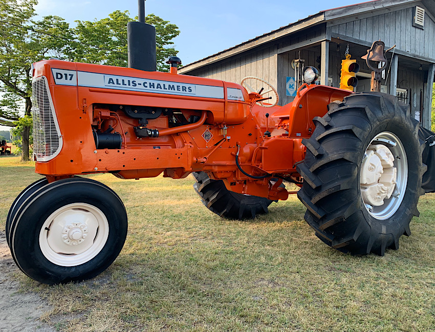

 I had taken this picture of two of the tractors in our Allis group! Can you tell which is the Firestone and which is the look alike?

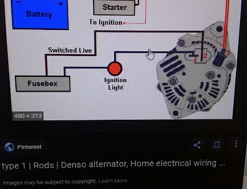

 I need a little electrical help. The Denso alternator came as it was supposed to be a 1 wire and not need a exicter wire. Well the supplier did not know much more than me and at low rpms it does not charge hardly at all. At higher rpms its doing good at 14.6 volts. I want to figure out which terminal is the right one for the exciter wire. There are two spade posts 90 degrees to one another. I could make the wire and try each one But I did not want to damage the electrical system by plugging in to the wrong terminal.
Tractor was not starting well. Had NAPA load test the Battree and it was putting out about 1/3 of the CCA's. So a new Battree came home too.
this was at idle:
Any thoughts would be appreciated. Tried googling it several times, but there are too many variations. I have put the exciter wire on other GM type alternators. I know how to put the diode in the exciter line to prevent feed back.
I am not a electrical guy!

I don’t know how I missed this but this is good stuff. I could be way wrong but it looks like you need to go from IG to #2.... however it’s very possible this may drain the battery over a short time too....that said you may need a batt shut off if you haven’t already got one.

 Thanks! That shows the "light" in the system, which I am not going to use, but I put a diode in the line.
I will try to hook up to the terminal #1 post on the alternator. Whats the worst that could happen!:)
Not sure what the "Switched Live" means on the wire connected to #2 terminal??
I know on the GM type alternators the third wire would be a short one and go right on the same #3 terminal. Maybe that whats its trying to say??
Not sure whats happening inside that fusebox??:)
If you hear a big boom up north you will know what happened!

Yessir and light should work too.Switched live from the ignition which you’d probably need a batt shut off to keep from draining the battery...I’m thinking.Type 1 top left.

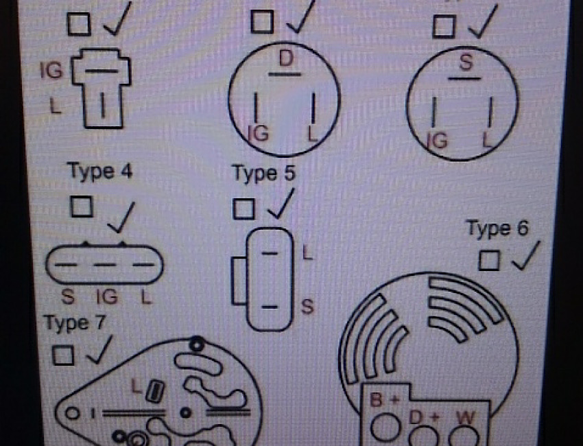

Yes the type of the terminals on the Denso is the one in the upper left. I found a plug on line that looks like the right one and it has a larger red and smaller yellow wire coming out of it.
On a GM type alternator the yellow wire would be for the exciter wire and the red wire would go right on the Battery "B" post of the alternator.

Info on here, the internet and talked to my local expert on the Denso alternators and he said the exciter wire going from the ignition switch to the IG terminal on the Alternator may or may not help to excite the alt at low RPM. I will try it. If it doesn't work I will just live with increasing rpm to get it to charge. The "L" terminal for a light doesn't not need to be used in this application.

Update for sure.I’m thinking it will work but like I said I’m thinking it’ll drain the battery so keep an eye on it and you may need to add a batt shut off if you haven’t already.

 Well I believe I put the diode in the right way and added the wire from the IG terminal to the ACC. When I fired the WD tractor up, it did not make a difference in the charge rate till I increased the rpm. So we will live with it. Also checked some of the other tractors and they are doing almost the same thing low charge rate at lower rpm too! Guess I thought they were charging more sooner??
