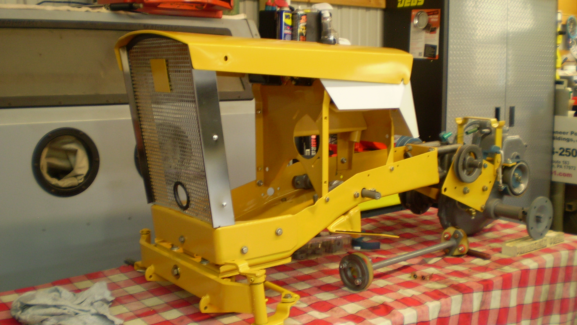

Here's a pic of my Big 10 going together. Hard to believe it was a total rust bucket. Has the hydraulic lift as well. Saved some parts, and replaced some parts. Haven't worked on it in a while. Busy with customer stuff.

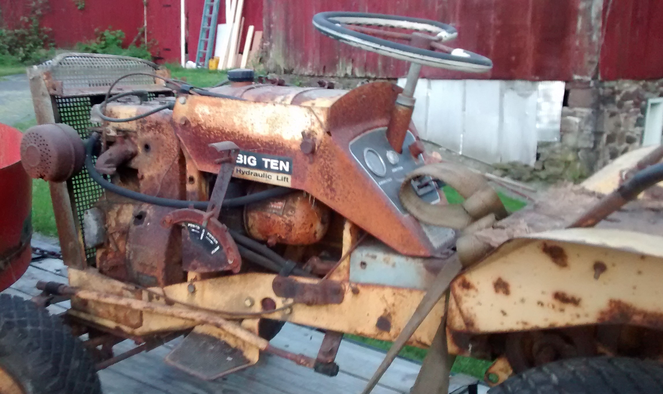

Before pic

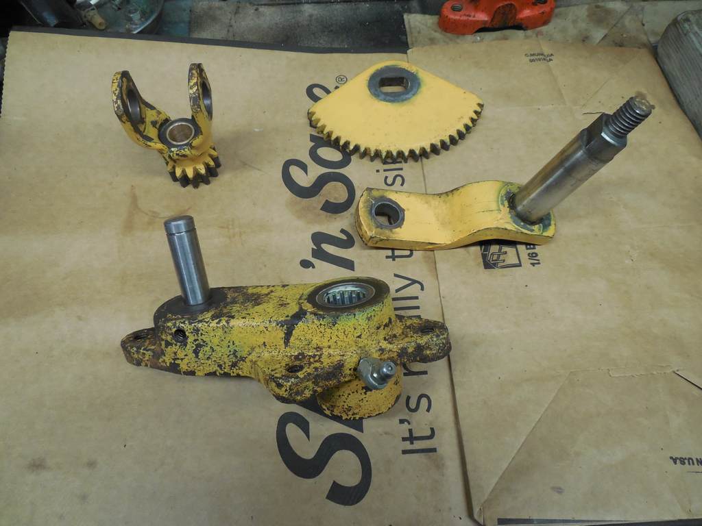

The gears are adjustable and you may be able to take some of the slop out with adjustment. The eccentric may also be worn as well as the bushing in the pinion gear. I found a bushing at the hardware store that was the proper height and O.D. but had to ream out the ID a little to fit the eccentric pin. Replacing the bushing and adjusting the gear lash should make a big difference. I also like to install new needle bearings and add a grease fitting to these assemblies. I position the fitting so that it puts grease between the two bearings but also sits above the frame at a position which you can reach with a grease gun when the side panel is removed.
