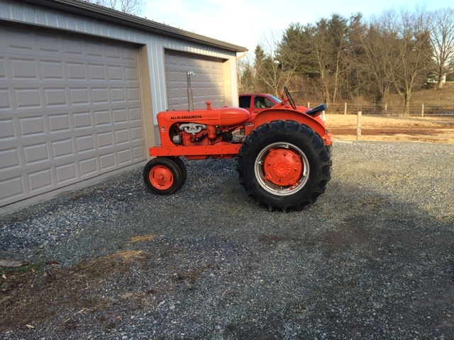

This is a picture of a 9 x 16’ door with 10’ ceiling height. 12’ will be nice if you want a lift, that is very tall though for a small shop. I have 12’4” for the barn.
That helps get the look with the Allis setting there. I know I have only a inch or two clearance with the Allis tractors under a 7 foot door. So that just has to have taller doors in the new shop for sure. !2 feet seems over kill today! Have to polish the crystal ball and look into the future.
Hey that's a nice looking Allis.

The 200 on 38” rubber will not fit with the full length stack (I believe is 4’?) everything 185 and under without a cab goes easily. I do think I’d go for the 12’ for a building your size though. Thanks for the comment on my old 45! Kevin
